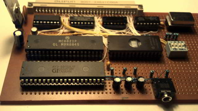

Derek_Stewart wrote:Hi,
My Qsound board, as shown above has through plating damage to the voltage regulator connections.
I can use a 7405 regulator, or could a TSR-1-2450 work the same?
I would use a 7805, because it has long legs, and you can use it to repair the tracks, this board has very low current, so the 7805 will not heat a lot, in fact I have it without disipator.
There is nothing wrong in use the TSR, but is the 2A one, so it's a pity.

aalea wrote:Which schematic your follow to do the interface? technology of chip? (74LS, 74HC....) model or ROM chip?
The one I posted here but using 74HC85 instead of 74LS266 (also 74LS03, 74LS10). I used 74HC00 to switch frequencies as posted here. Looking at source code PB0-PB3 are always output, PB4-PB7 as inputs. Unused PB1 is always output high by default (selecting 0.75MHz), PB0 (AY BC1) & PB2 (AY BDIR) are low when inactive.
