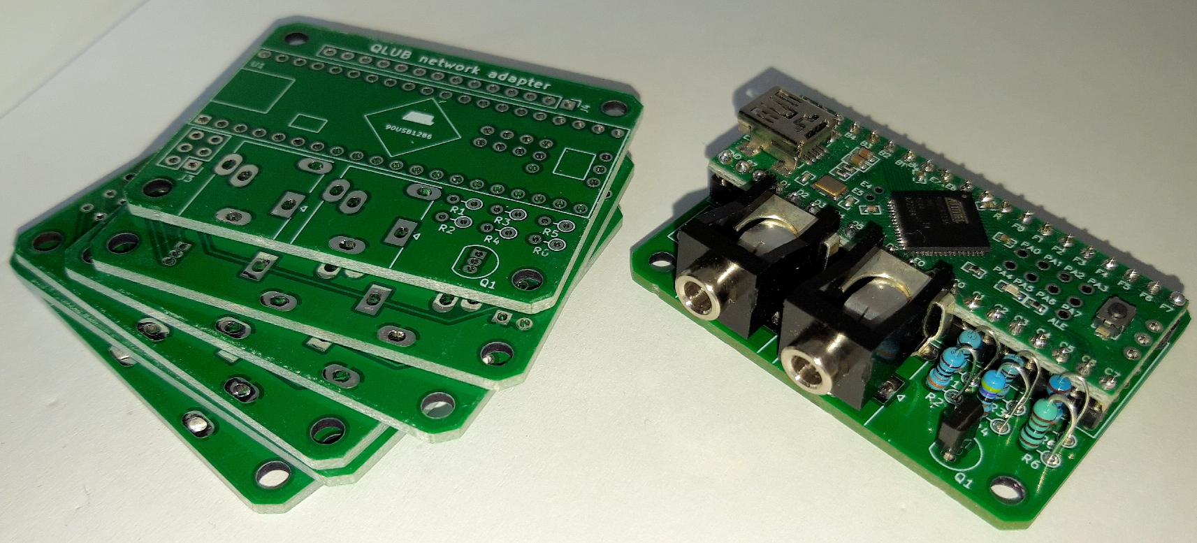

- Posts: 1400
Re: QLUB Adapter - Initial Release...
I had some of Marcel's boards made up. £1 each (PCB only!) if anyone needs one or more.
I have also populated one. To save you having to follow the traces...
R1 = 330 ohms
R2 = 330 ohms
R3 = 10k ohms
R4 = 47 ohms
R5 = 3.9k ohms
R6 = 1k ohms
The 3.5mm sockets I had laying around didn't fit, so I had to bodge them a bit and the whole thing won't fit in the 3D case now, but that's ok.
I wondered though (probably an obvious answer), can the Tennsy ++2.0 be re-programmed while it's in the board? Just in case it can't and for easier removal I have only soldered the 4 pins that are actually required.
R1 = 330 ohms
R2 = 330 ohms
R3 = 10k ohms
R4 = 47 ohms
R5 = 3.9k ohms
R6 = 1k ohms
- Posts: 1124
Hi Chris!
And thanks again to Marcel for his next PCB design!
Good luck!
Very nice indeedChr$ wrote:I had some of Marcel's boards made up. £1 each (PCB only!) if anyone needs one or more.
Absolutely - just make sure that the COM port used by the adapter isn't currently 'locked' by your QL emulator at the time you attempt to flash an updated image using the Arduino/TeensyDuino IDE - you can even leave the emulator running, as long as the SER channel is closed. I regularly re-flash updated versions whilst testing, switching between the running emulator and the IDE repeatedly within the same session.Chr$ wrote:I wondered though (probably an obvious answer), can the Tennsy ++2.0 be re-programmed while it's in the board? Just in case it can't and for easier removal I have only soldered the 4 pins that are actually required.
Good luck!
