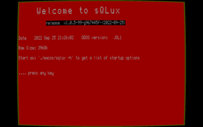

New features and coming thick and fast from @Exile.
This one is shader support that makes the uQlx output look much more like an old CRT screen (minus the smoke and nicotine haze of the 80s).
If anyone else writes any fun shaders they can also be added.
See the documentation for how to build/run as its not yet included in the standard build.
