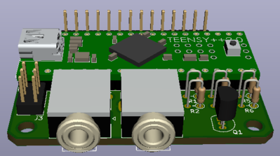

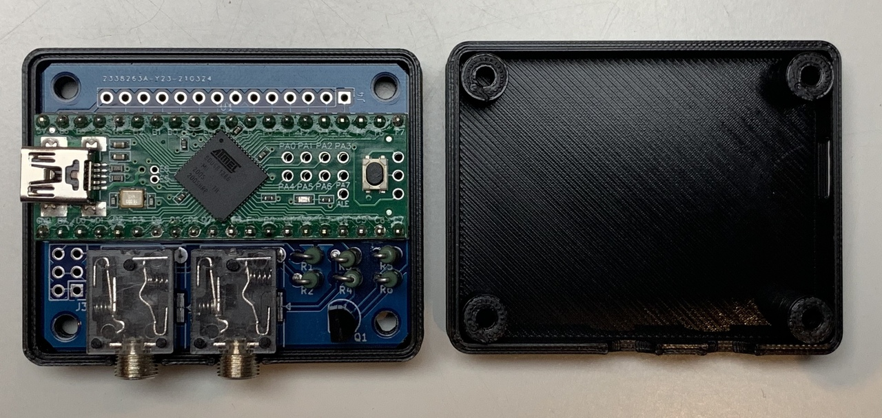

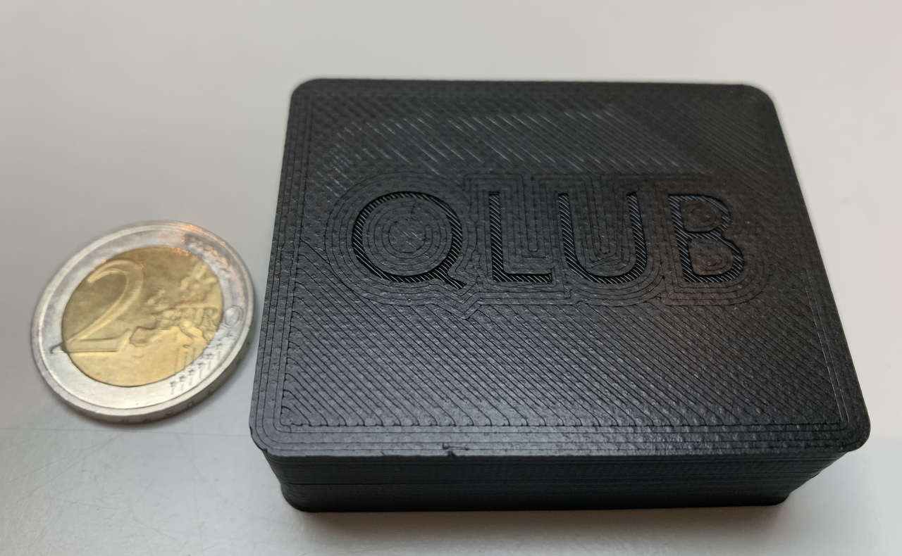

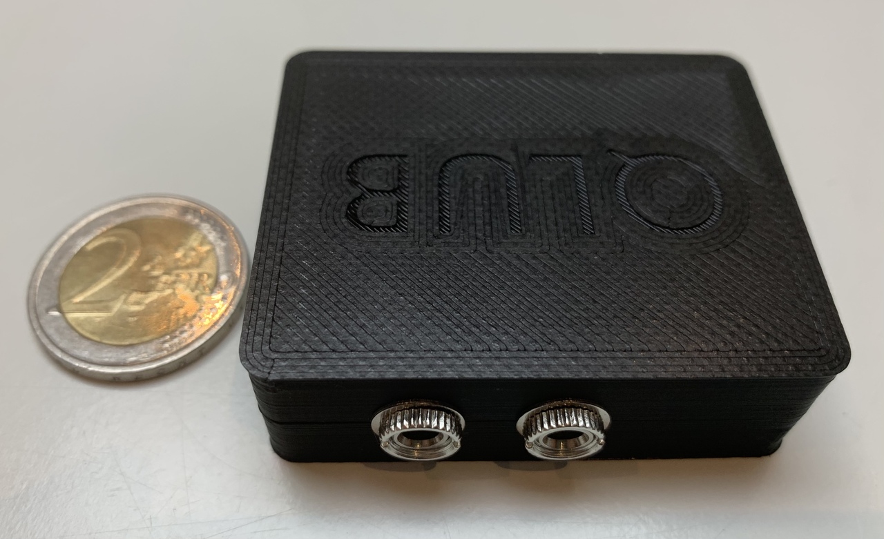

So, this has been a while in the making, but finally it's done: a QLUB PCB plus 3D-printed enclosure. Pretty neat, I think
I have attached all files for interested parties. All issues I encountered with the prototype are already fixed in these files, but I'm happy enough with the fixed prototype so won't order any new boards.
The PCB was done in KiCAD, but Gerbers are included. The enclosure was developed in OpenSCAD, but compiled STL is also already included. It's a screw-based design, aimed at 10mm M3 self tapping screws, but others may work too, or simply clue it shut
The footprint for the 3.5mm jacks is designed for the cheapest one I could find at Reichelt ("EBS 35"). I left enough tolerance in the holes that most cheap ones will fit I guess.
