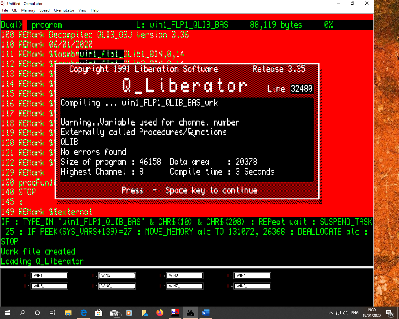

I have just done this ..
Now I will try to do a byte by byte comparison ...
Re: QLiberator decompiler
Oh, 3 seconds compared to Martin 's 2 hours with Qemulator? Can't understand this. What's about those Turbo lines? You should use a clean OS, without any extensions.
