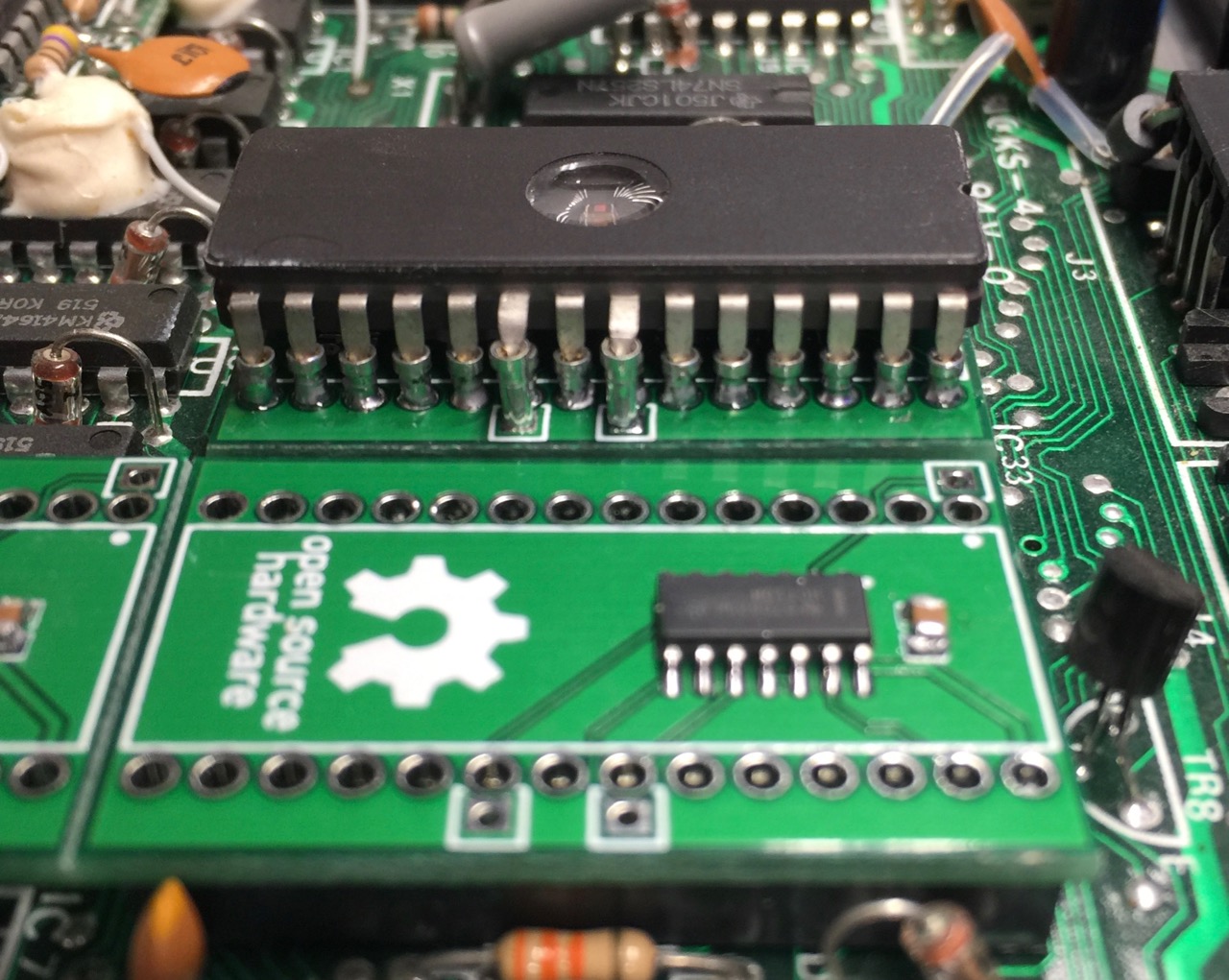

Derek_Stewart wrote:Hi Dave,
A question regarding the memory mirroring, does this mirror the complete QL memory map or does it behave like the Gold Card?
The expansion looks great, I really like MInerva and doing without Multi-tasking Basic is some what limiting.
The only thing that's not mirrored is writes into video RAM and the QL IO area, for obvious reasons. ;)
My only regret is that we couldn't include Minerva on board due to size restrictions.
Posts: 1579
Re: QL 34th Anniversary new hardware.
Shame it couldn't go underneath the board as a slim flash package...

Pr0f wrote:Shame it couldn't go underneath the board as a slim flash package...
Then how would people update it? You could program a flash in a QL, but you'd have to stop all multi-tasking...
I just decided it was easier to just give people a Minerva EPROM and adapter board free with purchase if they needed one. They're also available separately for £7 (standard Minerva/TKII image) or £8 (programmed with your custom ROM image.)
