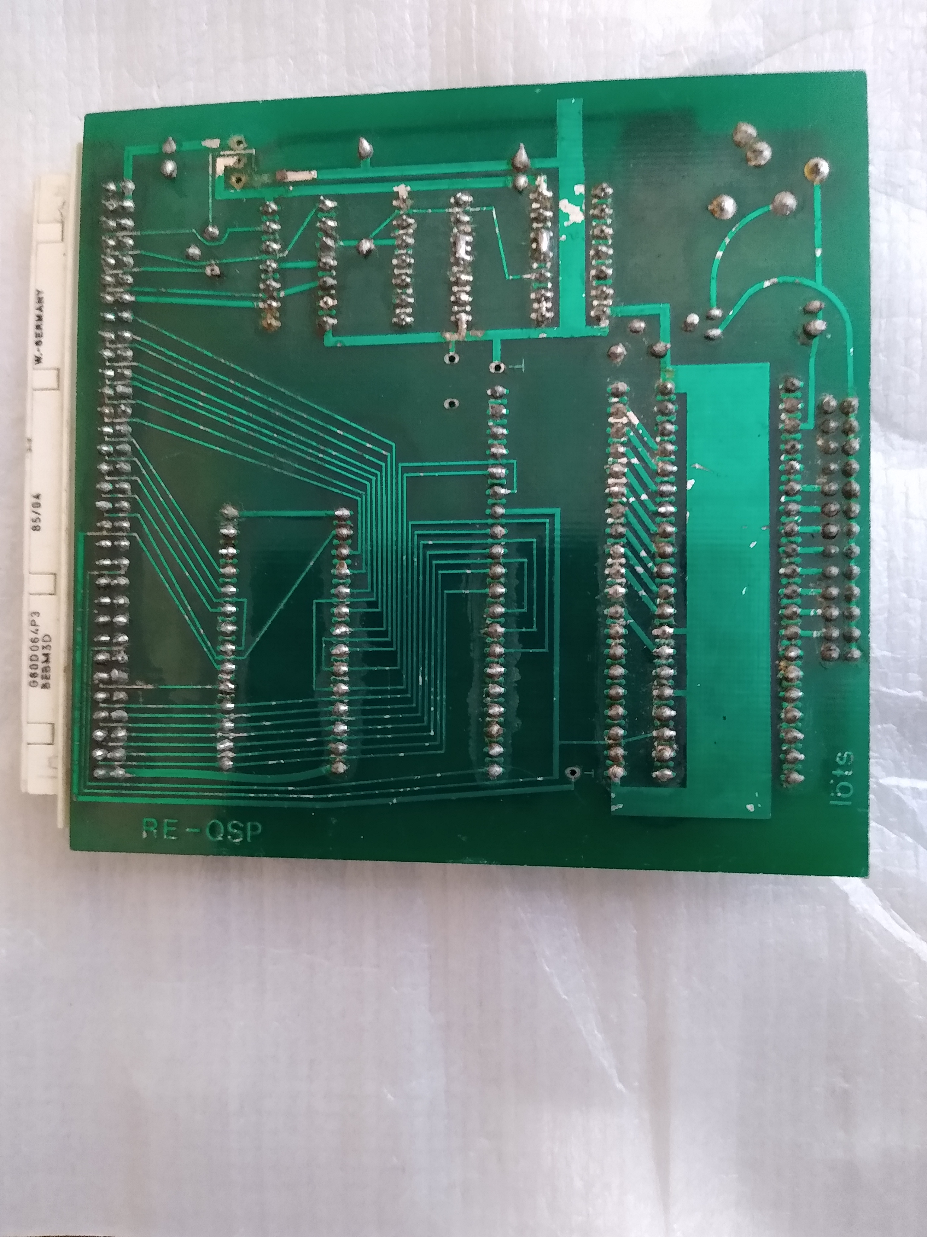

Can you (or somebody that have the original board) send pictures of the PCB, I'm interested in the botton of the board, there are some text (a name) that are not show in the pictures we have, and I can not transfer it to my design.
Derek_Stewart wrote:I am also going to order some PCBs, from your Gerber files.
Please, wait, because I suspect that en oor error are related to some problem in the PCB.
I can send you 1 of my PCB by postal mail, (it have some minor errors already detected) but not sure about the cost of custom from EU to UK.

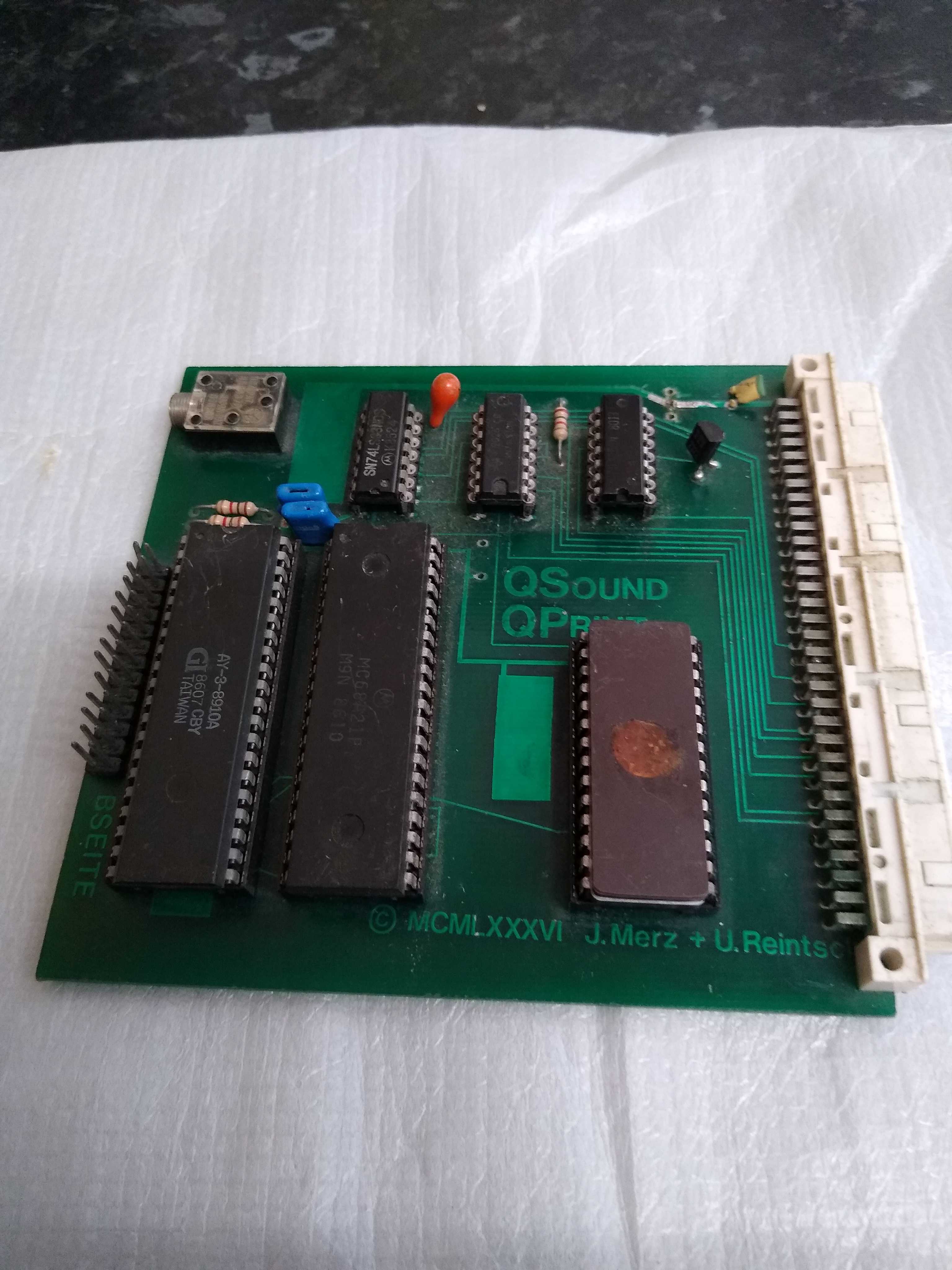

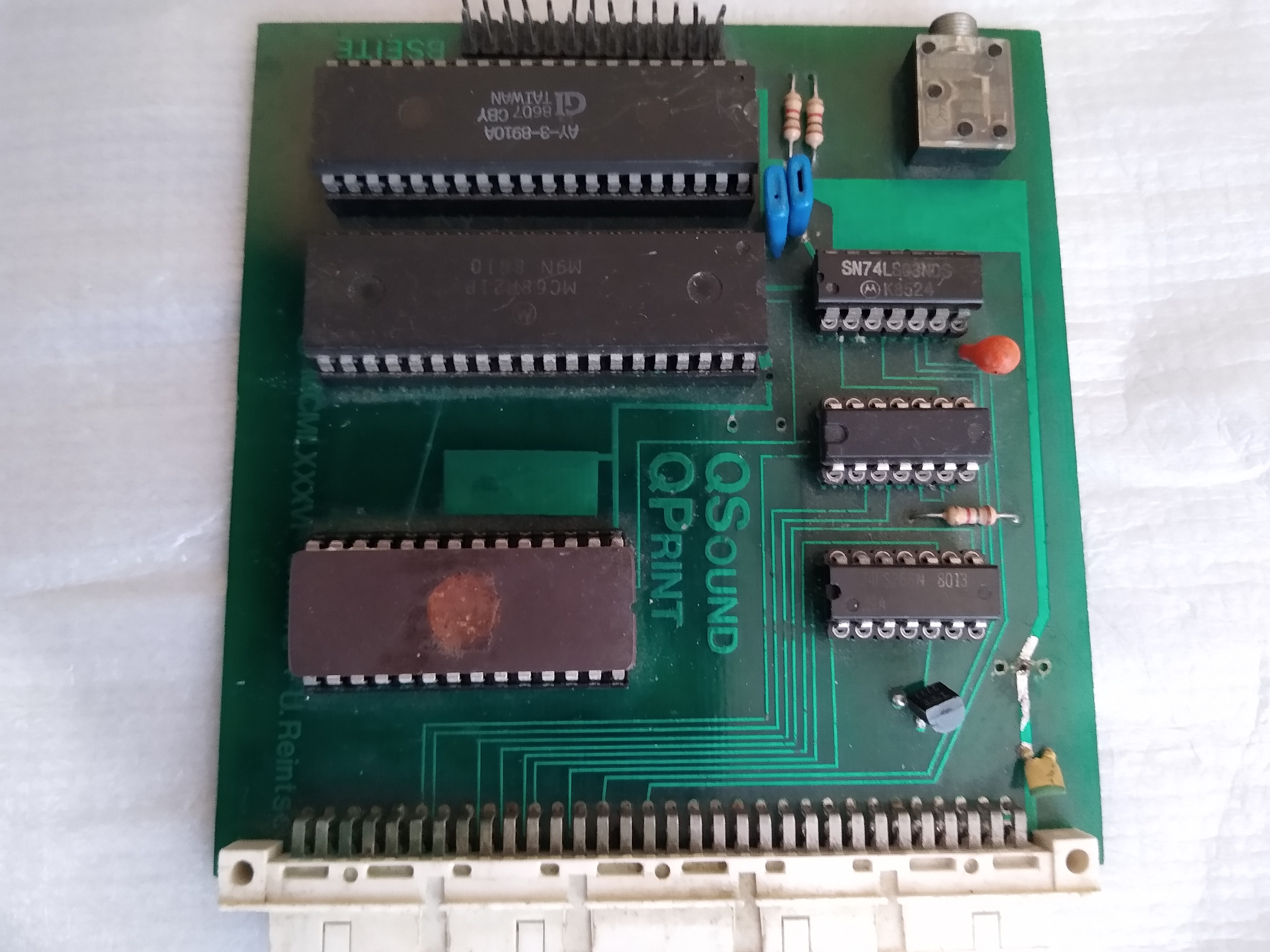

Here is some pictures taken with my mobile phone.
QSound Top
QSound Top
QSound top
QSound top
Qsound Bottom
Qsound Bottom
The damage to the board looks to be the voltage regulator through plating, which I will get repaired also with the tracks. Some of the soldered joints looks like they need cleaned up.
