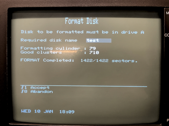

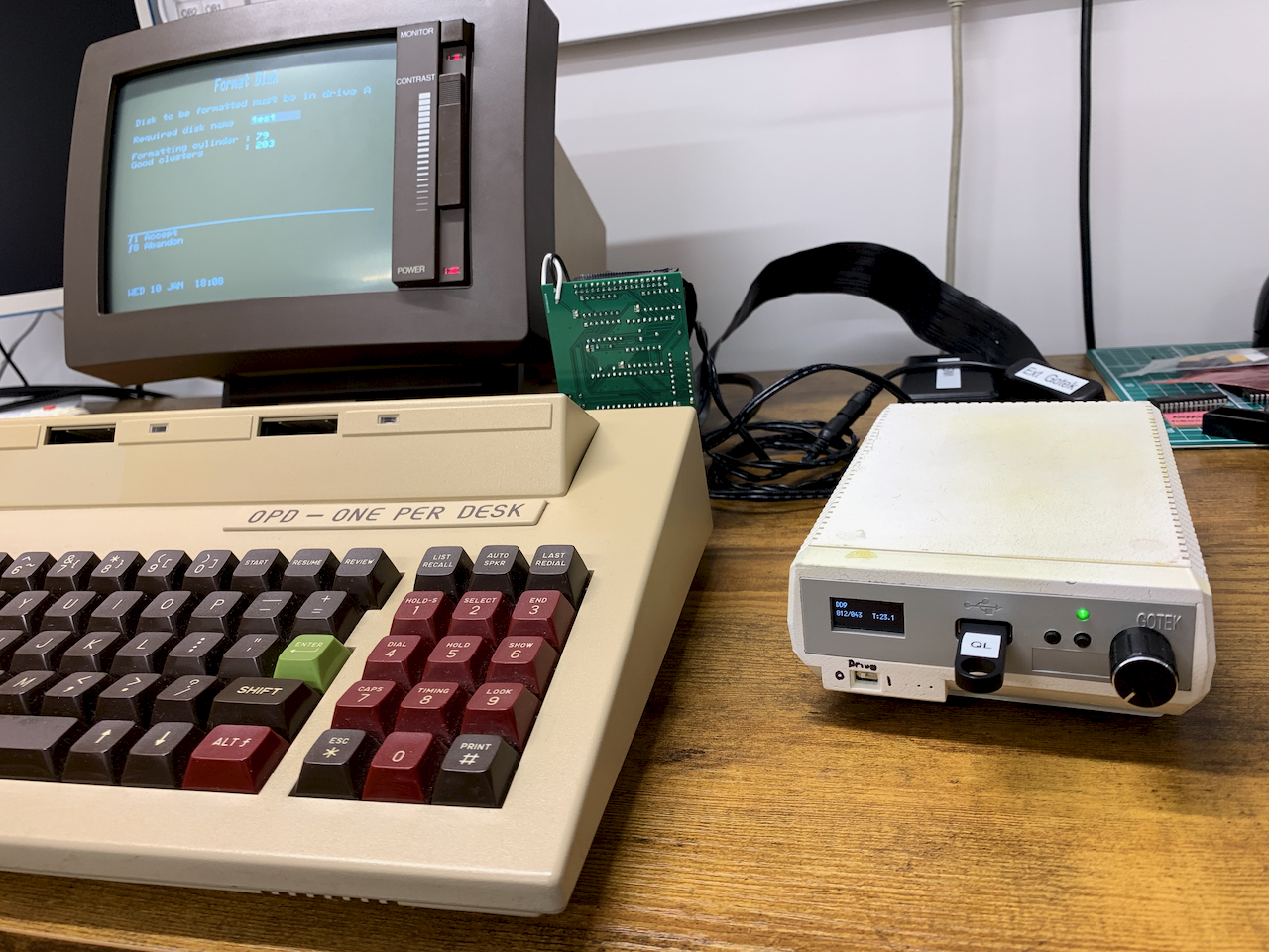

David Warne and Rich Mellor got the Computer One floppy interface ROM image to me today...
Wrote it to EEPROM, set things up, switched on and...
The interface only goes and works first time!

Re: ICL OPD
I've no idea how to access it from BASIC at the moment as I don't have a fully working version of BASIC as that comes on Microdrive and isn't built in.
As for the design being published. I'll work on a Mk.II which will fix a few things such as the connector having to be on the "wrong" side of the PCB and integrate my clock fix so as to use an crystal oscillator rather than a crystal and capacitors, which didn't work. I can also rework it to be two boards connected via IDC cable so it's not so tall.

Re: ICL OPD
The interface maps the floppies to the left and right Microdrives. As far as the system and applications are concerned it still has only the two Microdrives and nothing else.
