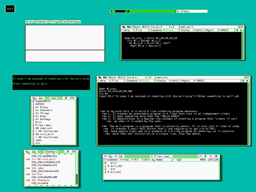

I was not expecting to be actually asked to write a 4 line program, then I realised that I use one on regular basis. When I looked at it, I thought some might see the 4 lines as a cheat, so I wrote a genuine 4 line program in the sense that it only contains one instruction per line. The whole caboodle is best shown in a screen shot as follows:-
Having checked if this post looks ok, I wondered why I had placed a clear_screen statement in line 3. I tried the program sans CLI #1 and found that bits of other widows can be left behind if it's not there.

Tinyfpga wrote:The whole caboodle is best shown in a screen shot as follows
Wow, what kind of a perfect program in four lines :D :D
