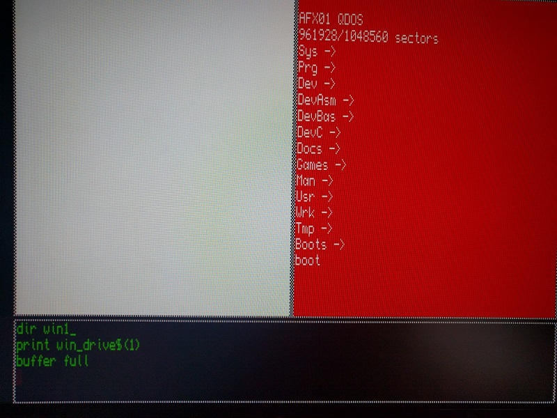

I am testing some specific functions and Q68/SMSQE commands. I have several drives configured (WIN1_, WIN2_, ... FAT1_, QUB1_). Everything works fine, but I have two questions about behavior that I don't understand.
1) The win_drive$ and qub_drive$ functions give me errors. For example:
PRINT WIN_DRIVE$(1) always reports the "buffer full" message.
PRINT QUB_DRIVE$(1) causes a system crash.
However, PRINT FAT_DRIVE$(1) work fine.

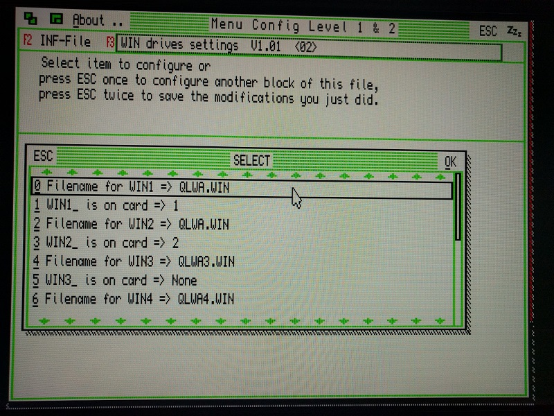

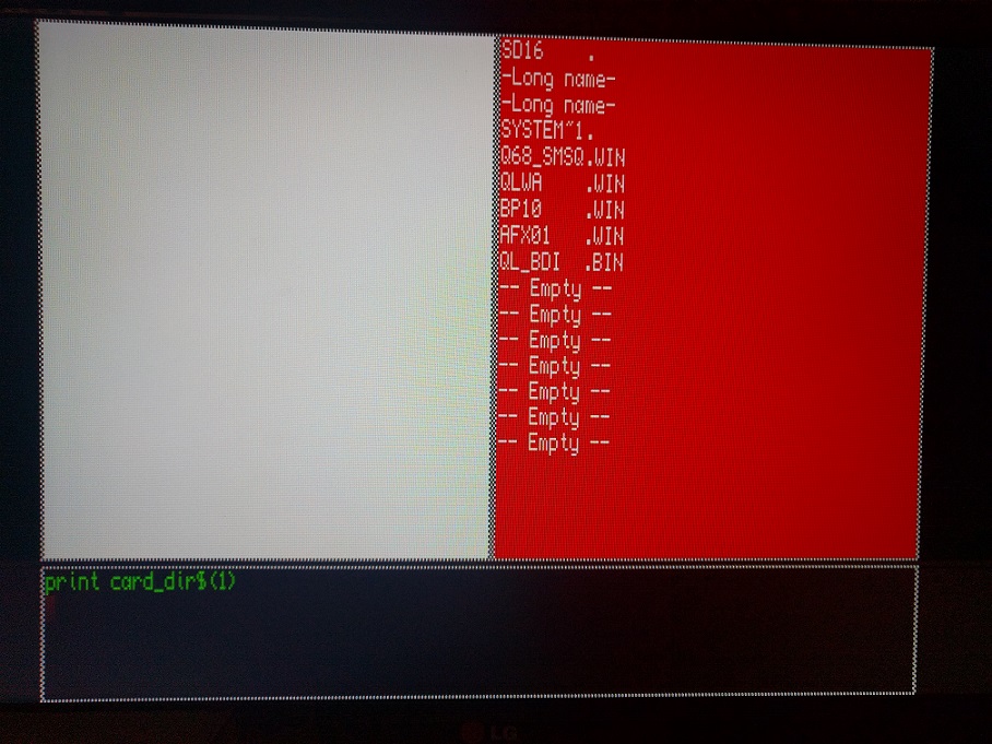

I have defined my WIN and QUB containers in Q68_SMSQ configblock. I have two SDs (slot 1 and slot 2) When starting, everything works fine (dir win1_ ... dir win2_ ... dir qub1_.... etc.). There is only one error in the win_drive$(x) function and qub_drive$(x). For example: The SD content with print card_dir$ (1) is as follows:

I'm just guessing, but that FAT32 directory looks suspicious to me. You should only have files with 8.3 filenames in the toplevel directory. Maybe save the OS binary and the filesystem containers, reformat the SDHC card, and copy them back.afx wrote:The SD content with print card_dir$ (1) is as follows
