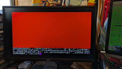

The plot thickens, I see that that IC24 IPC sends it interrupt to IC38 HAL16L8 mystery chip... which is also connected to !VPA so it could be using the 68000 slow peripheral timing for IO registers. I hadn't considered this 'till just now... with all my ROM and RAM tests I never witnessed !VPA in action... this looks like a whole new can of worms for me to investigate this weekend.
A small change to the FSM for bus access seems to have got Minerva 1.98 to boot and a slight delay Kludge in the read and write access routines when accessing $18020 & $18021 has got the keyboard doing something at last, just not quite what it is supposed to be doing;
- it's reading garbage even when I'm not pressing any keys :D
I think the problem I had with Minerva not getting through its RAM test may have been due to fast instructions to the hardware starting a new transaction before the !DTACK had gone high and it
might have pung through the next access thinking !DTACK had been asserted. I added a term in the state engine to stop the state engine returning to state 0 before !DTACK had de-asserted. This is not in the Motorola Read-Write cycle Flowchart but I found this hidden away in The Motorola M68000 Family Programmer’s Reference Manual;
"The processor samples DTACK on every cycle start to determine if the bus is ready."
And:
"DTACK must be de-asserted (high) before the processor begins a new bus cycle."
So I figure it will be ok. It has got Minerva booting anyway.
Time to go and watch a bit of Doctor Who - I'm up to "The Hand of Fear" with Tom Baker. It's so good. Back on to slow VPA peripheral cycles in the morning.
