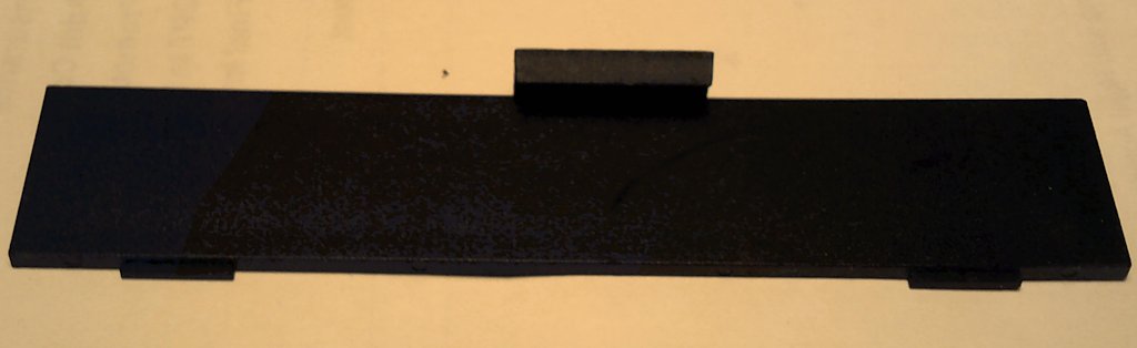

A QL user from the UK proposed the plastic cover of the QL extension slot to hold the D-Sub connectors (Joystick, SER). It would require modding the cover, but not the case itself. Does that sound sufficient?

Peter wrote:A QL user from the UK proposed the plastic cover of the QL extension slot to hold the D-Sub connectors (Joystick, SER). It would require modding the cover, but not the case itself. Does that sound sufficient?
Yes, I think it's a good idea.

But how many people have long since lost the cover? I have 5 QLs but can only find one cover :(

Silvester wrote:But how many people have long since lost the cover? I have 5 QLs but can only find one cover :(
That cover is absolutely easy to 3D-print. There's even a model on Thingiverse that could be modified to suit the connectors.

tofro wrote:That cover is absolutely easy to 3D-print. There's even a model on Thingiverse that could be modified to suit the connectors.
Oh that's neat, save having to drill out and file the holes :)
