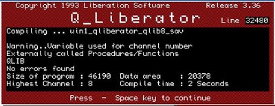

Ralf R. wrote:QLiberator self compiling under QPC also takes 2 seconds. Just by the way ;)
That's a huge speedup, from 2 hours to just 2 seconds, when using Q-emuLator. I imagine Q-emuLator must have been running at QL Speed.

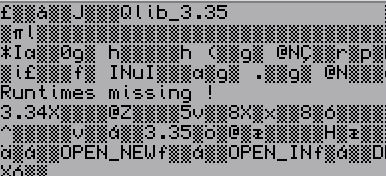

The version number comes from the compiler itself. The first _obj I made, was with the original QLiberator v3.35, then there is "3.35" in the compiled code, if compiled with v3.36, then there is "3.36" in the compiled code.
So where exactly does it appear? In v3.36 I can see 4 different places where these numbers appear.
The number is from the QLib, which has compiled the program. If no runtimes there it is just after the string "Runtimes missing" when viewed the _obj in an editor.

Ralf R. wrote:If no runtimes there it is just after the string "Runtimes missing" when viewed the _obj in an editor.
I'm pretty sure that the version number is also there when the runtimes are included as well. (I'm not sitting at the right computer to check)
Also that 3.3x version number is just before the start of the compiled SuperBASIC. If you look at that screen dump. If I remember the decompiled QLIB correctly, that 3.35 just above OPEN_NEW, is assigning a string variable to "3.35". And the OPEN_NEW and OPEN_IN are Q_ERR_ON's

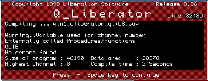

I have used the original QLIB_obj to compile and get a massive length of about 66,554 bytes, which is far greater than the 46,190 bytes of Martin's compile.
I've only tried this so far with QPC2, but I plan to try again using Minerva and Q-emuLator.
Posts: 1254
Re: QLiberator decompiler
This makes me wonder, I have got 46,190 with Lines, Names, Winds and Run off, Auto on. The same, as Martin got. Compiled under QPC2. I have tried nearly every combination of these but can't get a result of 66,554.

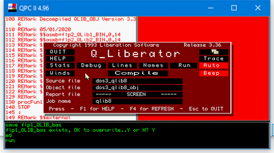

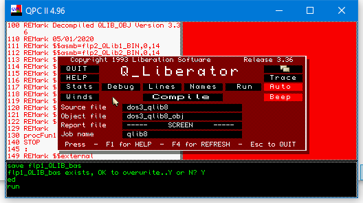

I've decided to release the decompiled QLIB_OBJ and QLIB_PATCH_OBJ files.
One zip file is a floppy disk image, and the other, is the files on the floppy image, all zipped up.
The files I have supplied are just what is required for QLIB and QLIB_PATCH. You will need to use the original LIBERATE command in QLiberator to create a _wrk, or a _sav file.
For the couple of people I have already supplied this to, There is an updated QlibPatch_bas file. The only difference is that it is more QDOS friendly.
This is the settings I used when compiling QLIB
