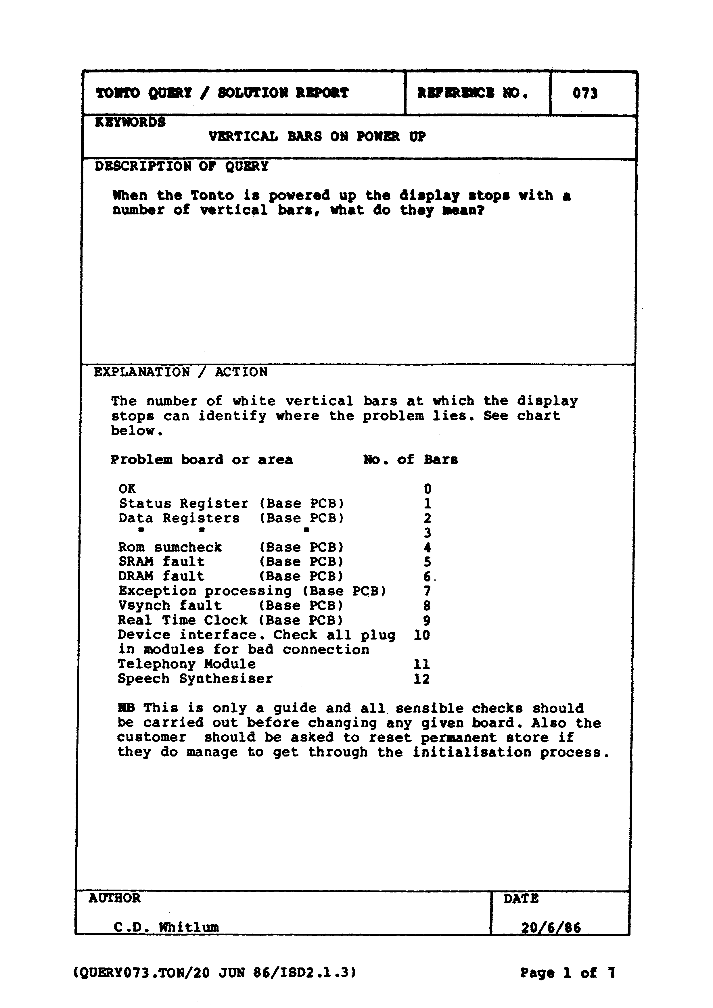

I've been having issues with my OPD not starting up and giving the 5 bar error, which according to this document is "SRAM fault"
This morning I traced the issue to /CE1 never going low. Chased the line way over to the left of the board to a transistor which inverted the input... which I then traced all the way back to just above the ZX8302 then to the rear of the board and... the power/video connector, specifically the "shutdown" pin. So the problem was in the monitor.
It turns out there was a bad connection on the "power good" signal from the PSU. From what I can determine the "shutdown" signal merely disables the SRAM, possibly to try to prevent corruption if the PSU isn't fully up to 5V? But they could just use a zener diode on the +5V rail for that.
Anyway, that fault fixed... new fault created, the keyboard isn't working fully now. *sigh*
P.S. Reseated the keyboard ribbon and the keyboard's OK again.
