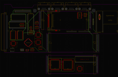

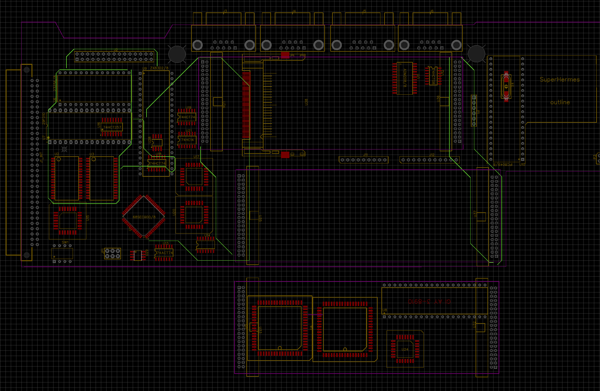

In a bit of "show and tell" here's the layout I'm trying, just experimentally:
On the left you have a ROM socket, a dual ROM/Flash socket, 512K SRAM and the CPU. The 8302 sits alongside them, tightly integrated (it really only has a slow serial link to the 8049 so that can be a long run) and glue logic where it fits best.
The keyboard membrane FFC connectors are central, and above and below them, two card areas (outlined in purple, with 2x20 headers each end - ignore the sideways header yellow graphic - that was just the first part I found at 4am!). Below the board, I demonstrate that this is the smallest daughtercard that can take the currently selected components.
There's maybe a 5% chance it'll end up going this way. The main thing is it leaves a lot of rear board edge free.

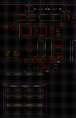

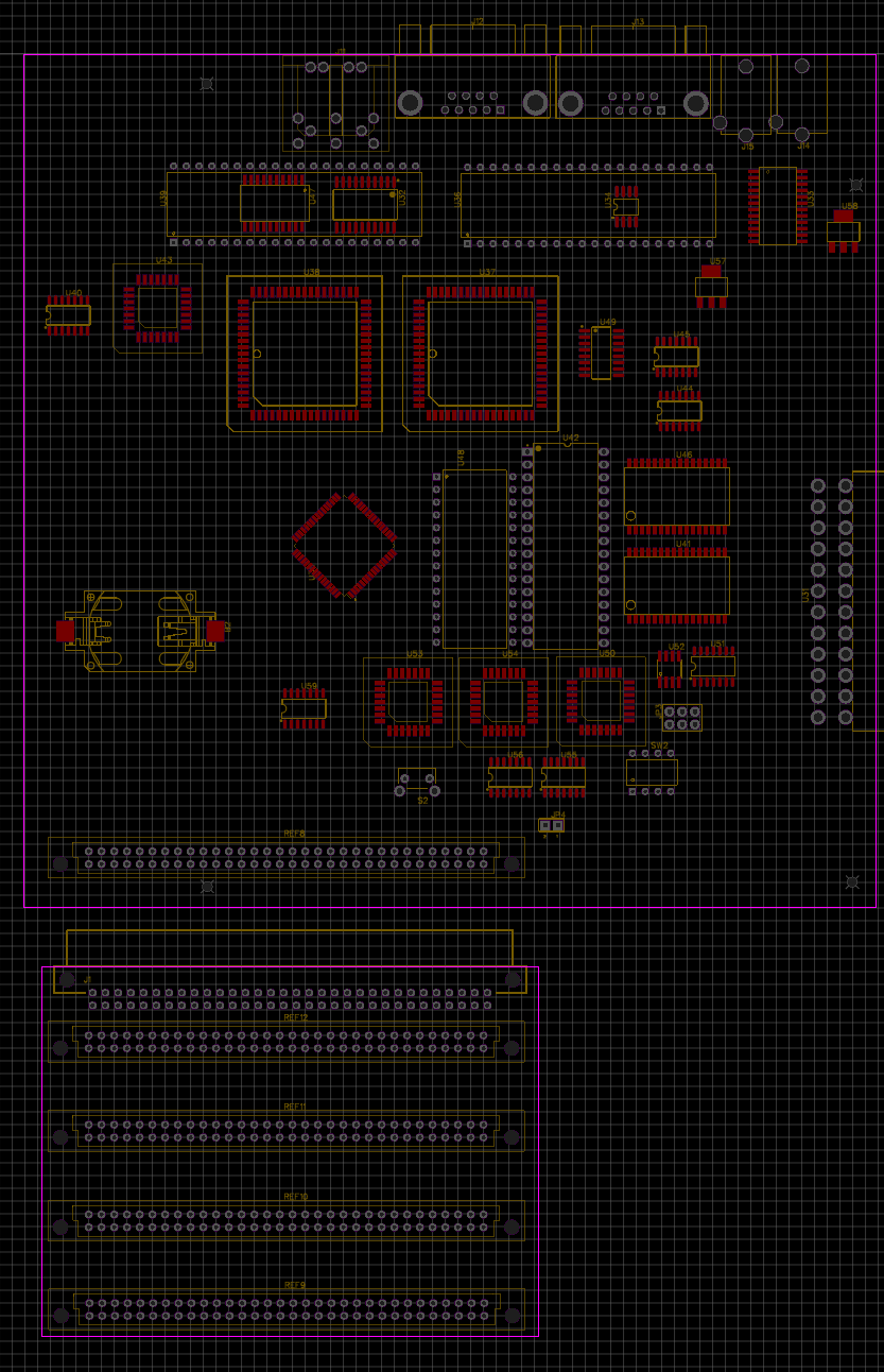

I also rough laid out a mini-ITX version that came together something like this:
My biggest bugbear is lack of a nice, high density, mechanically strong connector that is SMD. I'm open to recommendations. Mostly, the male and female sides, combined, need to cost less than $3-4, support multiple insertions and have at least 96 pins.

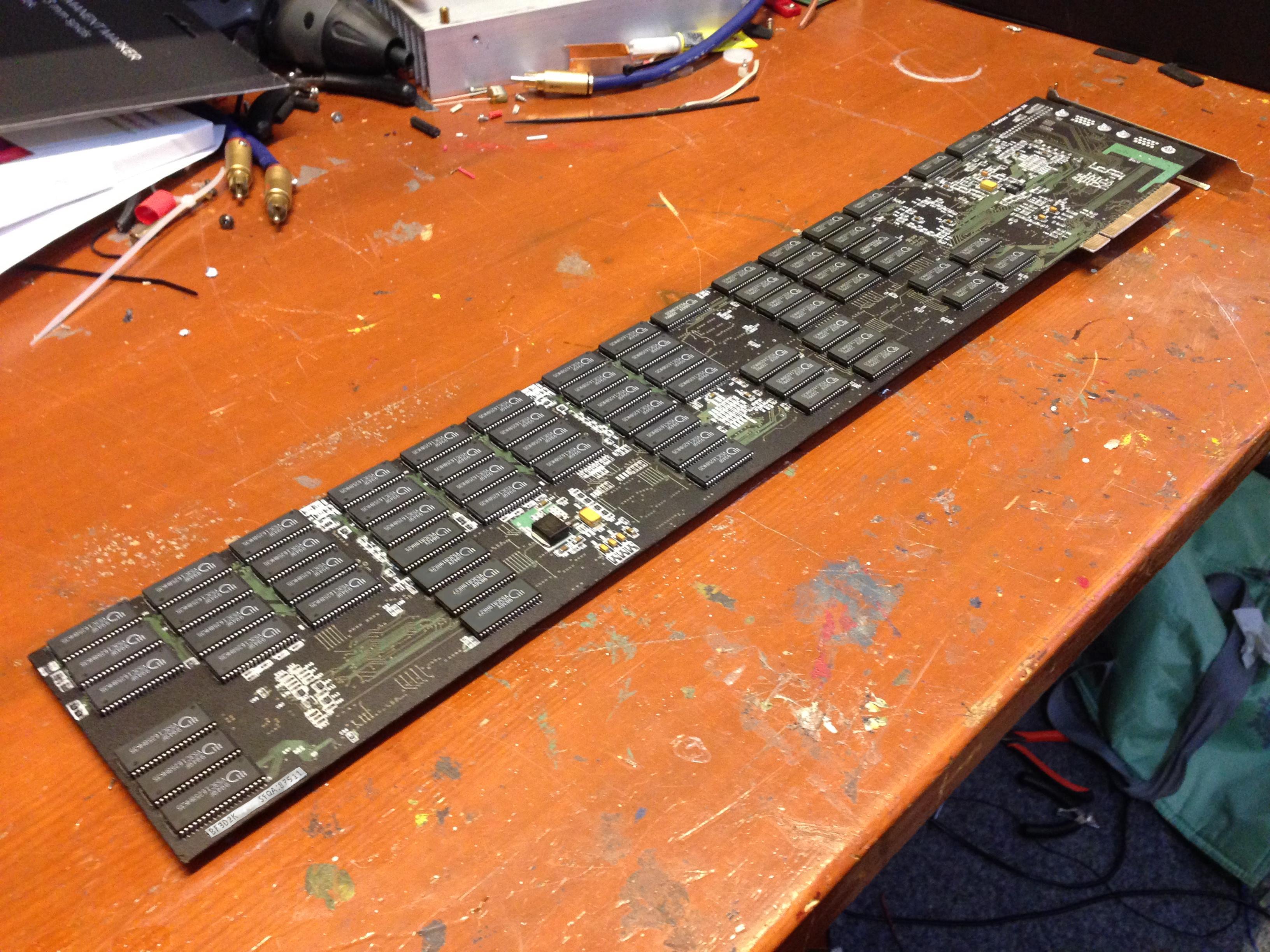

Re: Issue 8 discussions...
Famous last wordsDave wrote:Nasta just sent me a photo of the QL video card prototype:
I kid! I kid!
