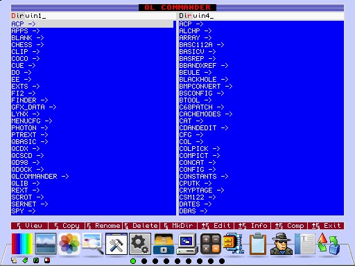

Andrew wrote:
QLCommander v2.0 is finally ready !
It runs on a Q68 high colour mode as well.
Just a couple of comments: the manual is provided as .pdf only this is not readable on a hardware QL system, could there be a Quill .doc version well. And two other things, the programs uses the QL_PALETTE command to change colour values for 'mode 4 colour', only problem is this is a global command so if there are other mode 4 programs their colours are changed as well and finally have you thought of adding FileInfo 2 support for file formats such .html or graphics formats not supported by the program itself.
Cheers
Artificer
Posts: 1061
Re: QLCOMMANDER - testers and help needed
Artificer wrote: Just a couple of comments: the manual is provided as .pdf only this is not readable on a hardware QL system, could there be a Quill .doc version well. And two other things, the programs uses the QL_PALETTE command to change colour values for 'mode 4 colour', only problem is this is a global command so if there are other mode 4 programs their colours are changed as well and finally have you thought of adding FileInfo 2 support for file formats such .html or graphics formats not supported by the program itself.
Cheers
Artificer
I had no time to crate a Quill doc, but I will. No pictures in quill doc, I'm afraid
I saw that QL_PALETTE changes globak colour values for mode 4, but I had no idea how to do it differently. Can you suggest a way to change the colors only for QLC ?
I did not knew that Fileinfo exists - but I will see how it works. It should be possible to execute it from QLC, with the file name as parameter. Where can I download Fileinfo 2 ?
Great if you could find time for a Quill doc. You can get FileInfo2 from herehttp://www.dilwyn.me.uk/utils/fi2v3e50.zip on Dilwin Jones download pages. As for changing the colours for "mode 4", obviously if smsq/e is configured for mode 4 then only mode 4 colours should be seen. If QLCommander is to run in mode 4 colours while running on a system configured to use GD2 colours the mode 4 colours are in the standard PAL palette, colour number #0 = black, #1= white,#2=red,#3=green.
