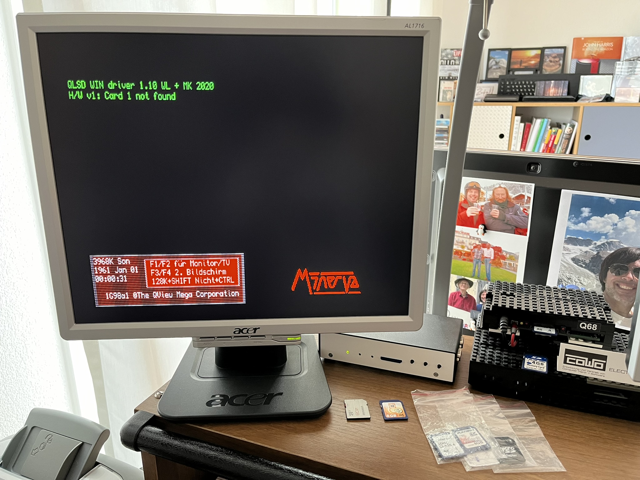

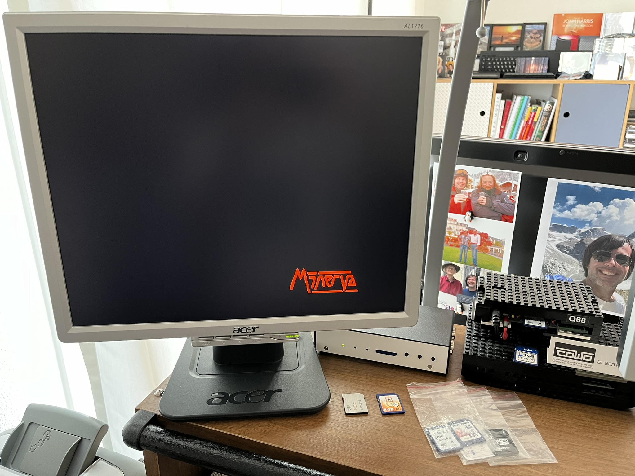

While this core runs well at Markus (Desin) on his MIST, I have huge problems at startup on my MIST in about 9 of 10 tries. My "QL" hangs at the red Minerva logo and does not show the expected F1/F2 window! In case it's hanging the screen looks like this: In case it's not hanging, the screen looks like this:
I have prepared a ZIP file https://sinclairql.net/downloads/ql_xra ... JAGUAR.zip with the minimal set of files:
Can you folks try this setup and report back, if and how stable it runs on your MIST.

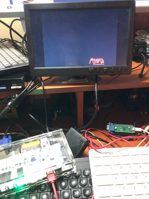

Tested today on MISTICA. With no QXL.WIN or a modified SD it boots 9 of 10 times I tried with different ROMs and RAM configs but with a correct prepared SD with a QXL.WIN it hangs 9 of 10 times with the Minerva logo... and if it not hangs at the start it can't load the .WIN and goes to the prompt or hangs loading something:QLvsJAGUAR wrote: Sun Feb 11, 2024 5:39 pm Can you folks try this setup and report back, if and how stable it runs on your MIST.
