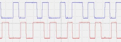

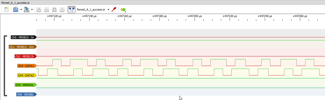

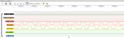

After a bit more reading and also looking closely at some digital traces I took during a FORMAT, I agree with you - seems we are using Diferential ME.
EDIT: I should have added that the above trace represents a section of alternating 1/0 (FORMAT writes $AA $55 in to its 'special' extended sector format. Each DATA line is therefore either %10101010 or $01010101 as the two bytes are split alternately across the two DATA lines.) Furthermore, the two DATA lines will be slightly out of phase based on the time taken to write each consecutive byte to pc_tdata. The sequence of 2 or more 0x00s at the beginning of each header (sector or block) before then 1 0xFF apparently allows the 8302 to find the start of each independent DATA stream thus 'synchronisng the PLL and setting the read-registers to a byte boundary', as described in Dickens' mighty, but sometimes confusing reference...
We see the DATA lines remain HIGH when idle, which matches the ME standard too.
As for decoding, it doesn't seem too tricky with a microcontroller to hand, though a little more complicated than the simple XOR of CLK and signal needed for straight ME.

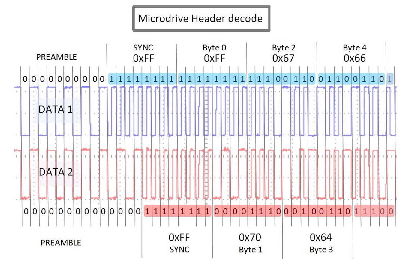

To better understand how data is encoded for the Microdrive here's a diagram:
As already deduced, the encoding scheme is Differential Manchester (aka Biphase Mark, FM, etc.).
A transition within the clock period denotes a '1' and no transition denotes a '0'. The clock is
embedded in the data by ensuring there is a change of state at the end of every clock period.
Before data can be decoded the clock must be extracted. At the start of every
header, or data block, there is a sequence of 'zeroes', the sole purpose of which is to lock the
decoder's clock. This is followed by a sync byte of 8 'ones' (which can be decoded since the clock
is now known) to define the byte boundary. With the decoder now locked and synchronised, data
can be extracted from the encoded stream.
The original recorded data is interleaved (byte by byte) between DATA 1 and DATA 2. DATA 2 is delayed
by 4 bits so that each byte can be sequentially provided to the QL by the ZX8302 after decoding.
Also notice that the data is encoded with the least significant bit first (hence when reading the
oscilloscope data it needs to be reversed).
Note that DATA 1 and DATA 2 in the diagram above appear synchronous. This is because the output
was captured from a vDrive QL which doesn't suffer from problems associated with the mechanical
limitations of the Microdrive. It is easier to see the relationship between the two channels when
they are in sync.

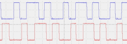

Real data looks more like this (and this is a good example - it can get much worse):
Various problems such as azimuth misalignment (leading to phasing differences between channels) or
fluctuating signal levels (leading to mark/space ratio variations) provide a challenge for the decoder.
Due to these real world variations, decoding is required for each data channel separately. Given what

Going back to the earlier decode diagram, the example data (after the sync bytes) is from a header
and gives the hex sequence: 0xFF, 0x70, 0x67, 0x64, 0x66
The first byte (0xFF) indicates a header, the second byte (0x70) is the sector number, with the following
bytes being the first three letters of the cartridge name (0x67, 0x64, 0x66 => 'gdf' - it was one of my many
test cartridges hence the random characters).
