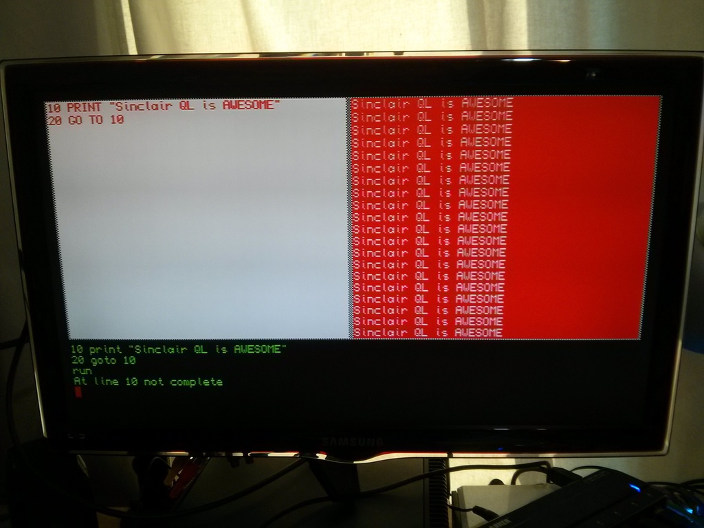

My box has also arrived today, here is a picture running on my Samsung TV.
I did not have to do any setup, after a few seconds of not finding signal on HDMI it seems to auto switch to SCART here.

XorA wrote:My box has also arrived today, here is a picture running on my Samsung TV.
Interesting, I'll have to try it again and leave it a little bit longer to see if mine will eventually auto detect and switch like this.
You're right, it does after a while. That'll teach me to be patient...
