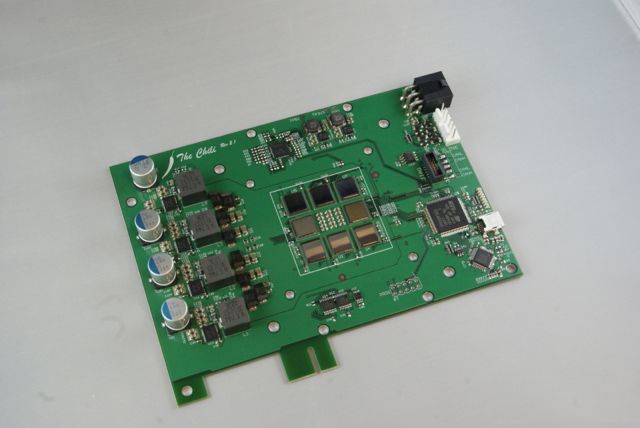

Re: SDHC adaptors...
The usual gear:
Pair of Weller TCPs with temperature read-out. Anti-static work area. GQ-5200 hot air rework station. Board preheat plate and reflow oven. 30MHz digital oscilloscope. Bench PSU. CCD board inspection camera. Eagle workstation.
Through my makerspace I have access to a Kenthe pick'n'place machine, reflow oven, and Trotec laser cutters (great for making solder paste templates). 100 MHz digital and analog oscilloscopes, NatSemi 16 channel data capture, etc, all the usual gear. Also, a Shopbot Mini that has been adapted to mill PCBs - not good at fine work <.4mm but good for doing boards for PSUs, etc.
Through my board maker, up to 8-layer 450x450mm boards with everything. Quite cost effective compared to high tax EU prices, and my preferred way to order boards. I save a LOT of money by panelising the boards. Also really helps with pick'n'place.
By hand, I am comfortable doing consistent work down to 0805. For larger amounts of smaller items, I can time-effectively just use the pick'n'place machine if it's a longer run.
My recent work - a bitcoin miner I assembled - contains 8 x 0.5mm pitch BGAs.
