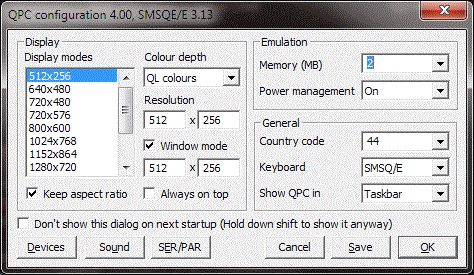

Some games will not work in QPC2 due to the fact that it is based on SMSQ/e - the replacement operating system for the QL - this means that the screen and system variables are not necessarily located in the same place as on a black box QL ($2000 and $28000).
The fact that the pointer environment is also built into SMSQ/e does not help - as some programs expect to overwrite sections of the screen which do not belong to them!
A lot of the software which does not display anything on QPC2 can be made to changing the initial parameters (hold the SHIFT key down when starting QPC2 if the configuration screen does not show up). Change the display mode to QL and screen resolution to 512x256.
Configuration screen of QPC2 set to emulate a standard QL as best as possible
