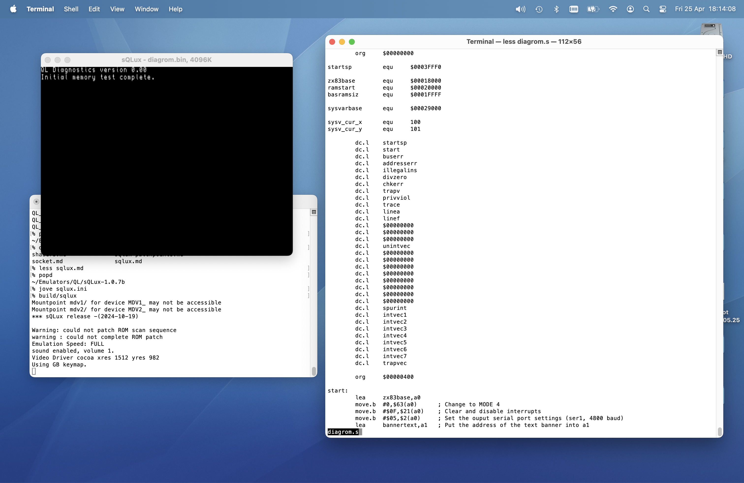

Tiny first steps.... My m68k assembler is *SO* rusty! Not done anything in earnest since the late 80s!
I wonder if this will work...

Starting to get somewhere with the ROM now.
Initial 128K memory tests (own address & march tests) not using RAM done and working. Basic string output to serial (probably) and screen working.
Now to figure out initial IPC tests before I can go to a test menu and read the serial port and keyboard for test selection.

Re: Wondering if a "dead test" ROM is feasible on the QL.
Yes, it's replacing the main ROM, as in remove QDOS ROMs and fit an EPROM with an adapter, as you would with Minerva.Pr0f wrote: Fri Apr 25, 2025 7:31 pm I was looking at your source code - just realised that your ROM is starting at 0h not C000h
I wondered why you had all the exception table in there![]()

We could probably make this a community effort if people would like to contribute.
As long as the routines save all the registers and restore them before returning it should be safe. I've set up a "system variable" area and the stack is in the lower 128K of RAM which has been tested.
There are utility routines for sending strings to the serial port and a rudimentary screen driver which can position the cursor and write strings (and interpret carriage return and line feed). I'll be finishing off the ANSI compatible cursor positioning routine, CLS for serial and screen and a scroll for the screen. That should be ample for any information display.
I'll look to set up a Github repository, maybe over the weekend.
