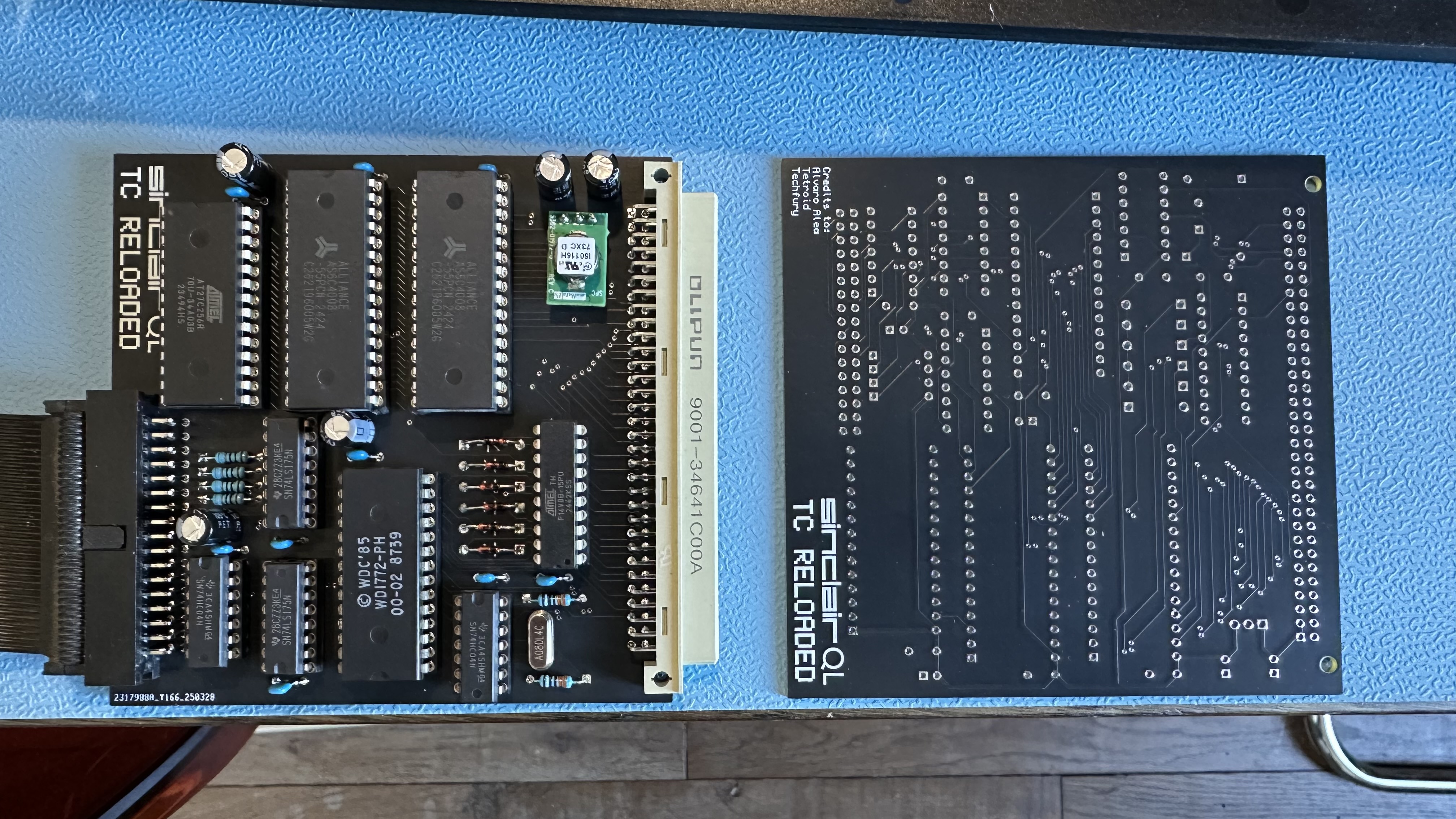

I have redrawn the board a bit. My OCD kicked in a bit when I saw the RAM and ROM at a 14 degree angle :ugeek:
But I used the same schematic so fingers crossed...
And I ordered a WD1772 replacement from vRetro. I believe that one is based on an FPGA. It would be nice if that one is working too. The WD1772s are getting harder to source, so a modern replacement would be very welcome.
Anyway, back to the soldering station... I'll report back when I have not blown up my QL...

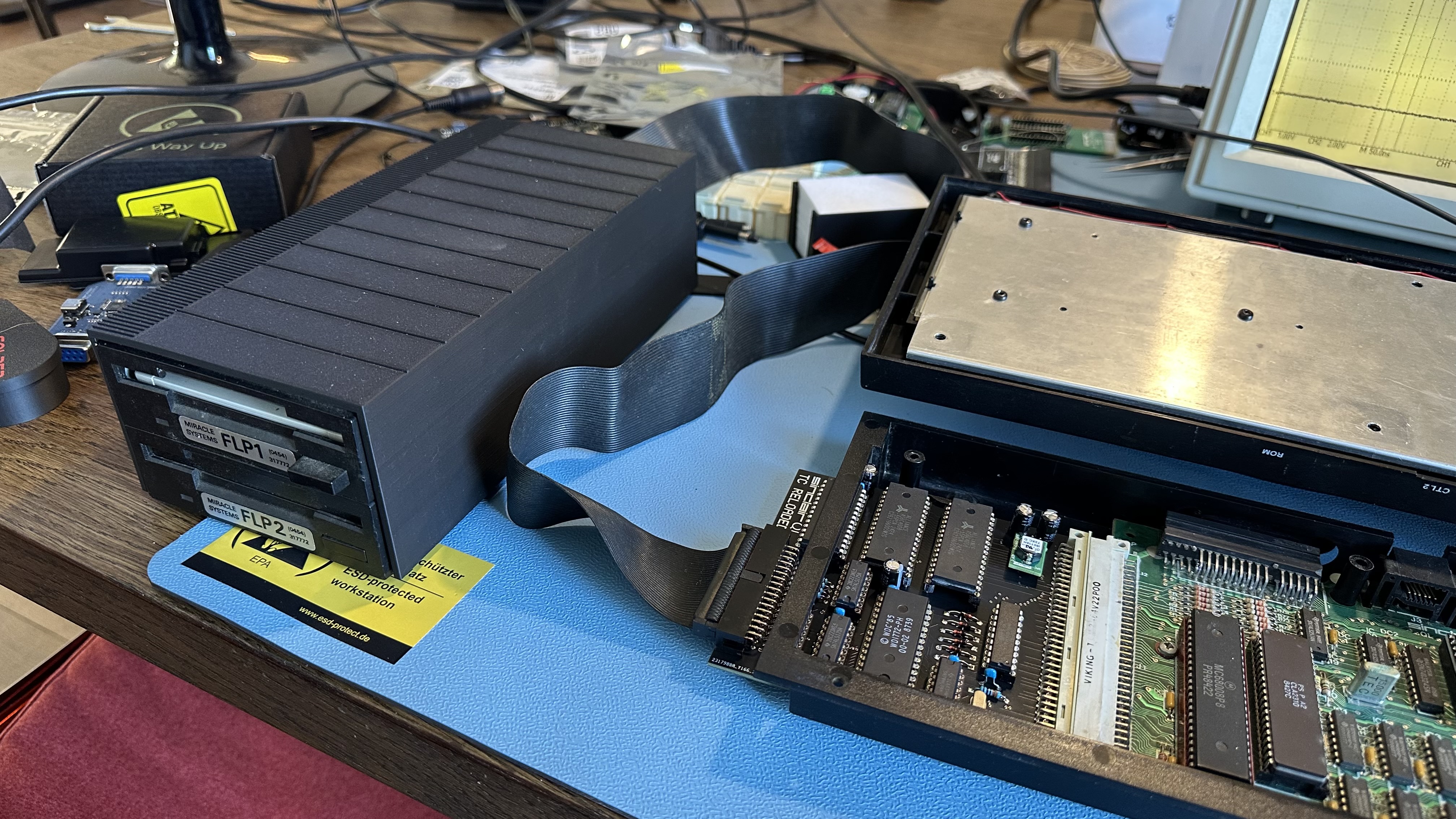

Moment of truth...!
It fits alright!
The only thing that bothers me is the green buck converter. Probably going to replace it with a black Traco or similar version.
And yes!!! It is working! No magic smoke... QL reports 896K of RAM and both floppy drives are working.
@techfury, I can confirm that the WD1772-PH 00-02 version works. I hope to receive the vRetro version of the WD1772 and test that one. Would be nice if it did as that would mean that it can be built with readily available components. Haven't check the current draw yet, but everything is cool to the touch, except for the WD1772 and the 16V8 that get slightly warm. But that was to be expected I guess.
Thanks to techfury, Alvaro and Tetroid for the work they already did.
Time for a beer now here in the NL. Going to enjoy the sunny weather while it lasts...
