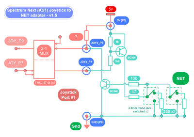

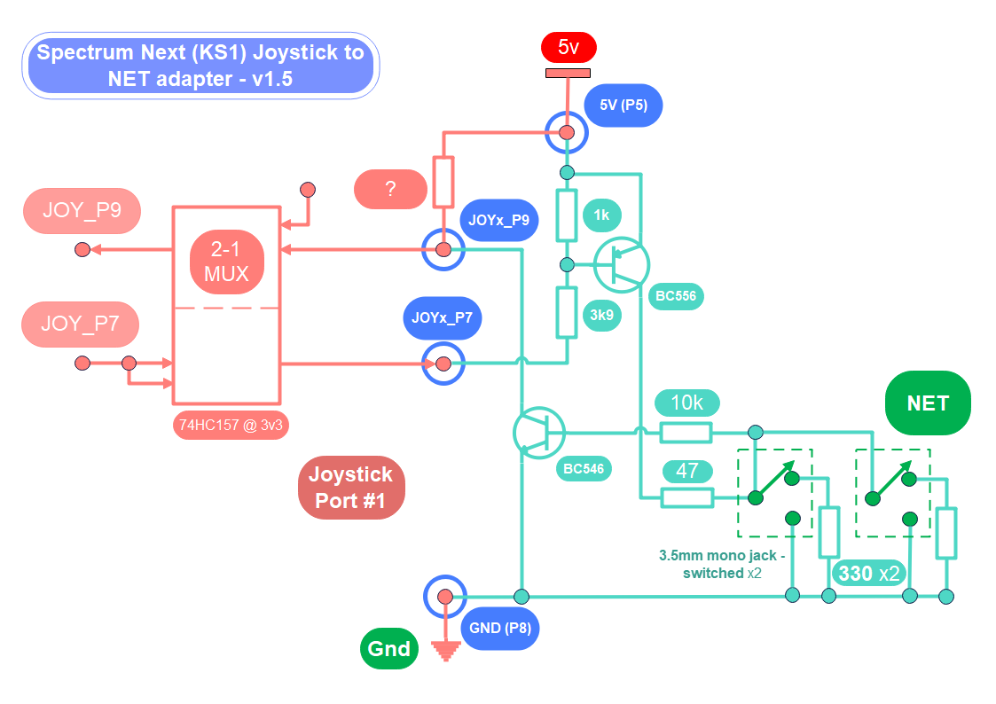

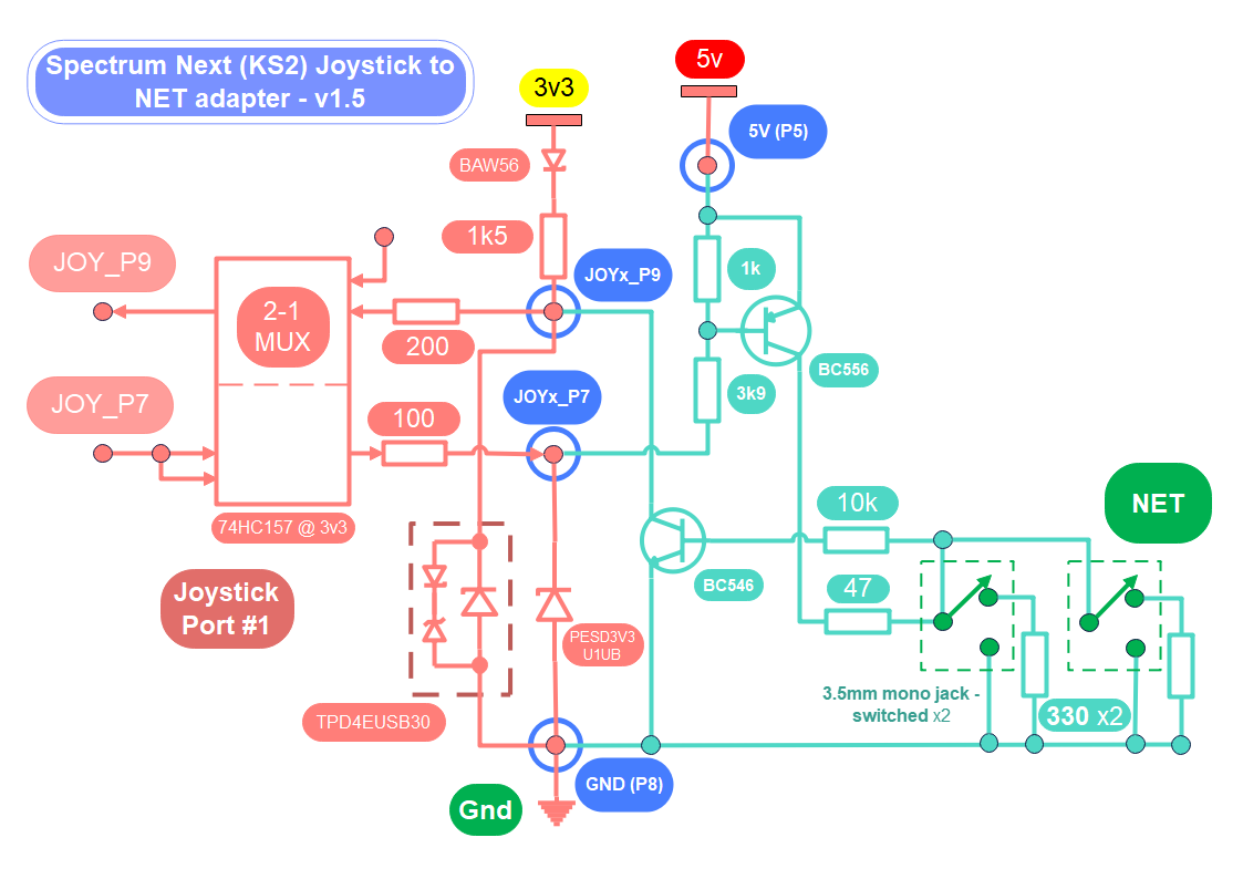

On a slightly tangential note, I thought to share the schematic of the small and simple hardware adapter that will be needed to attach the Next via its JOY1 port to the QL/ZX Network. The latest driver is v1.03 - so look for that on the SpecNext site in due course (I only just finished updating it a couple of hours ago...)
The 'mechanics' of the Joy2NET adapter need some further thought, but my first version worked perfectly well on a breadboard, so anyone should be able to assemble something fitting
In the two attached schematics, the items in green represent the components needed in the adapter - the pink items are just there to highlight the relevant differences inside the KS1 and KS2 machines JOY1 ports to which the (same) adapter connects.

Hi Martyn,
has either JOY_P7 or JOY_P9 direct connection to an FPGA I/O pin?
In that case, the much simpler Q68 circuit could probably be used.
Leaving only the 3.5 mm jacks, a schottky diode (e.g. BAT43), one 47 Ω and two 330 Ω resistors.
Leon just needs to make some simple FPGA changes.

Unfortunately, a simpler arrangement like you suggest didn't work due to how the Joystick ports are wired on the Next with an active pull-up on Input pin-9 and, in order to ensure the voltage and current drive (c24mA) of the original Net spec, it was necessary to provide additional drive from the HC157 at the output.
This was the simplest configuration/number of components I could devise after a number of iterations and testing, though I'd welcome further ideas/refinements!
They are actually buffered via a HC157 mux.Peter wrote: Fri Dec 06, 2024 8:29 am has either JOY_P7 or JOY_P9 direct connection to an FPGA I/O pin?

Thanks for the explanation, I have no schematics of the Spectrum Next, hence no further ideas.
