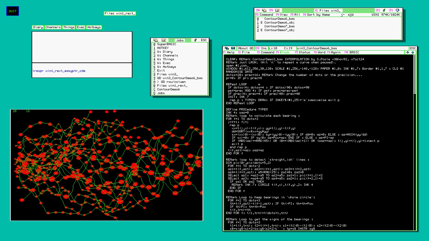

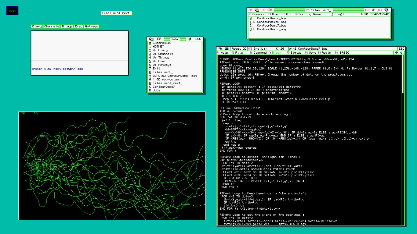

Tinyfpga
Posts: 315
Re: Curve smoothing
Post by Tinyfpga »
Just UNZIP & LRUN. Please report any other quirks you may detect.... Regards, Steve.
From my perspective it is quite quirky, but that is because I use SMSQE at high resolutions and thus need programs that are moveable within its extended environment.
The program LRUNs on my SMSQE setup, but does not execute as an SBASIC job. It will not compile using QLiberator with or without line numbers.
I like the program and felt it was worth modifying it to be moveable and compilable without line numbers. The most difficult bit (for me) was eliminating the program's GOTOs. The result was a compiled moveable program that might be used to create animated wire frame images, if only I could understand how it works. As you say "the program is quite lengthy".
The really quirky thing ,now, is that with GOTO's eliminate the code cannot be interpreted but works perfectly when compiled. If interpreted it fails with the error:- "At line 2160:1 Return not in procedure or function"
I post a container file with copies of the modified code for the Contour program with and without dots. I tried to modify the original as little as possible.
Win3.zip
(473.42 KiB) Downloaded 139 times
