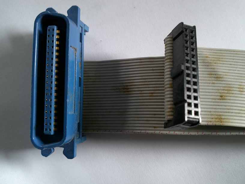

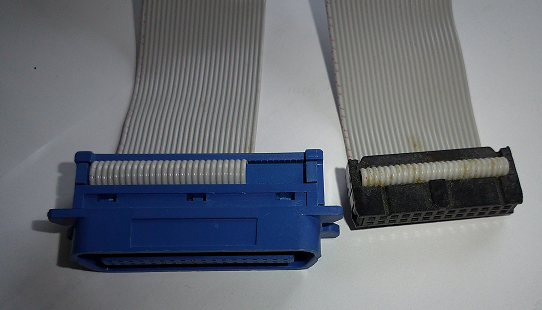

I've got this cable, which I think came with my super/gold card
It does not have any holes punched in it I can see. And it's about 5 feet long.
Posts: 1115
Re: Printer Cable for SGC
Martin_Head wrote: Tue Oct 01, 2024 10:35 am I've got this cable, which I think came with my super/gold card
Hi Martin,
That looks exactly like what I was looking for
I've managed to source a couple of the Centronics plugs so will have a go at building one
Is there any chance of a picture of the other side of the centronics plug so I can see the ribbon entering it please?
Tony

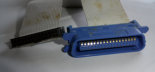

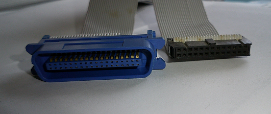

Here's some more pictures
Posts: 1115
Martin_Head wrote: Wed Oct 02, 2024 9:52 am Here's some more pictures
Many thanks Martin

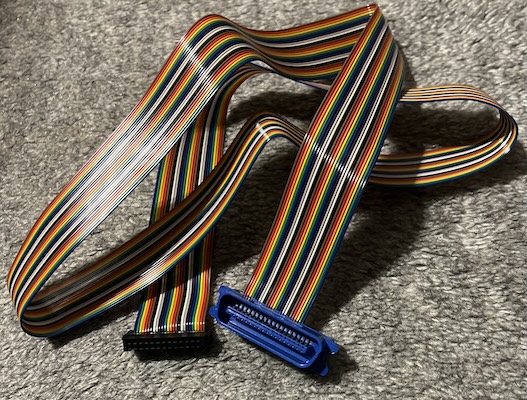

Well I've made a cable and it works! (at least I listed my boot file to retro-printer ok)
Sadly, the centronics plugs I got don't have any cable management to grip the cable more, so will keep a look out for better ones
It doesn't look very "original" in colour either as rainbow cable was all I had available
If anyone does have an original cable they don't mind parting with (for a price of course) I'd still be interested in obtaining one please
