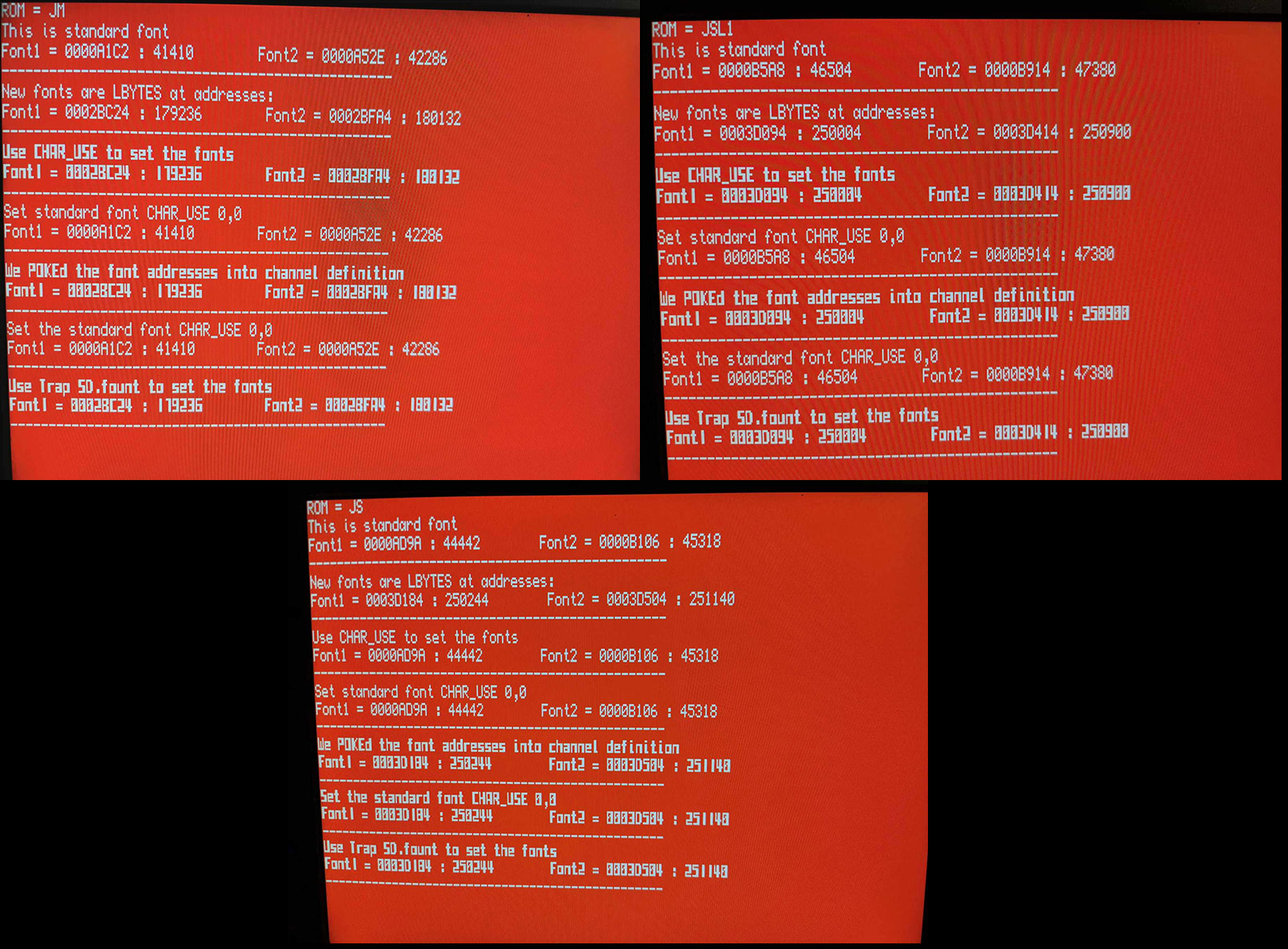

I used DYI toolkit extension chans_code to read the font addresses
JS ROM - the values are not changed in the definition block
Minerva, JM, MG, Spanish MG - the values are changed in the definition block and the font is used
8  TK2_EXT
9  LRESPR mdv1_chans_code
10 CLS
15 PRINT 'ROM = ';VER$
20 PRINT "This is standard font"
25 ShowFontAddress
35 x=ALCHP(875):y=ALCHP(875)
45 LBYTES win1_digital1_fnt,x
55 LBYTES win1_elaborate_fnt,y
65 PRINT "Fonts will be loaded at addresses:"
75 PRINT "Font1 = ";HEX$(x,32);" : ";x
80 PRINT "Font2 = ";HEX$(y,32);" : ";y
90 PRINT "-------------------------------------------------"
95  CHAR_USE x,y
100 PRINT "This is the loaded font"
110 ShowFontAddress
120 PRINT "-------------------------------------------------"
130 CHAR_USE 0,0
140 PRINT "This is standard font again"
150 ShowFontAddress
1000 DEFine PROCedure ShowFontAddress
1010 Font1=CHAN_L(#1,42)
1020 PRINT "Font1 = ";HEX$(Font1,32);" : ";Font1
1030 Font2=CHAN_L(#1,46)
1040 PRINT "Font2 = ";HEX$(Font2,32);" : ";Font2
1050 END DEFine ShowFontAddress

1. POKE works for all ROMS, including JS
2. SD.FOUNT works for all ROMs, including JS
3. CHAR_USE is not working on JS ROM to set a font or to revert to standard fonts, but works on all other
4. I do not have a JS ROM :( I think that I have another ROM switcher stashed in some drawer, I'll look for it.
This is strange. I expect CHAR_USE to also use SD.FOUNT trap :?

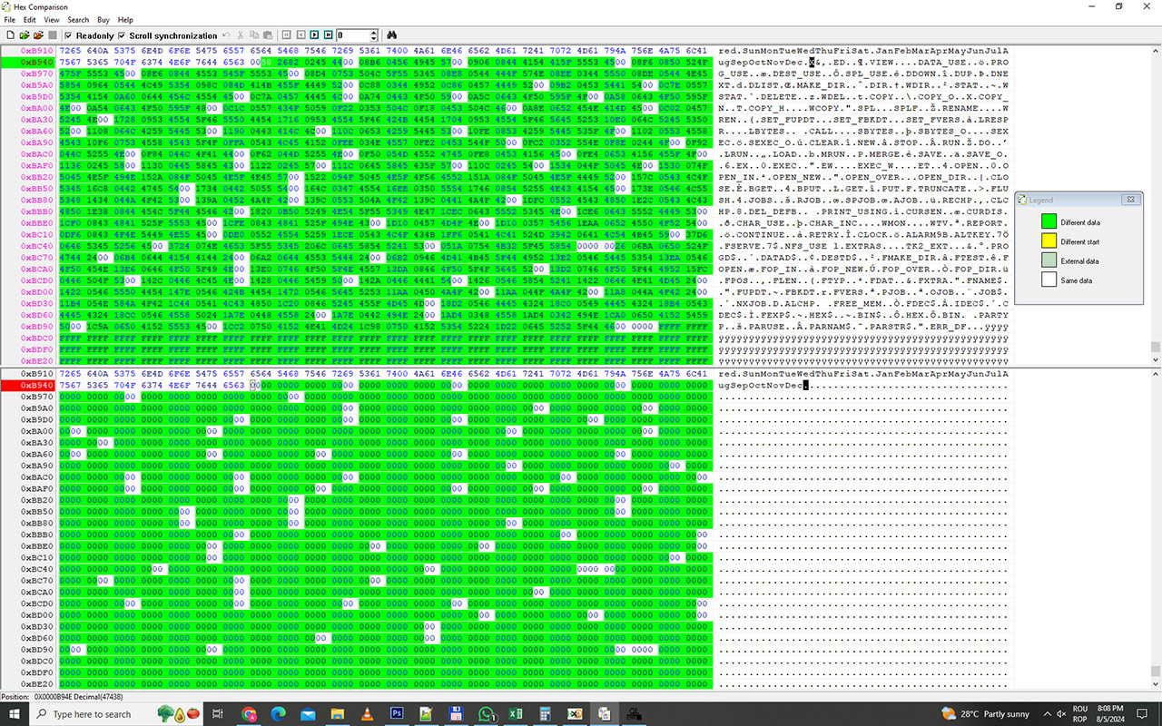

Thank you Martin - now we are getting somewhere.
I saved the JS ROM from the switcher and and loaded in QEmulator - it works perfectly.
But the JS ROM has some differences compared to the JS ROM downloaded from Dilwyn's site. It seems that it ends with a piece of TK2 or something ...
Also at address 254H the switcher rom has D6C0 while the JS ROM has D7C0
Nevertheless, it works in QEmulator and CHAR_USE works properly.
I disabled the ROM TK223 and LRESPRed TK236 on the bbQL - and with it, CHAR_USE is working properly.
I do not know what it means. All ROMS from switcher use the same TK223 - and with all ROMS except JS, it works.

Andrew wrote: Mon Aug 05, 2024 7:03 pm But the JS ROM has some differences from the JS ROM downloaded from Dilwyn's site. It seems that it ends with a piece of TK2 or something ...
That looks like a single bit error in the EPROM/FLASH (whichever is in the ROM switcher).
