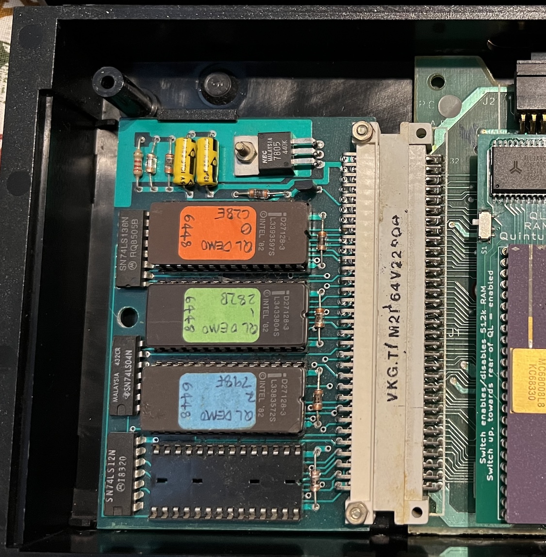

May be I could do something with this? Though it would tie up the expansion slot

Never seen one of those before - what type is it (or is it homebrew) ?
As you say, ties up the expansion slot.
And depending on where in the memory map that puts the ROMs, might not allow expansions like Trump Card which use space allocated for ROMs to make up the difference between 640K total RAM and the 896K total of Trump Card.
Never tried adding a Minerva via the main expansion port, don't know if all signals needed are present there.

Posts: 1201
Re: To Minerva or not to Minerva...
dilwyn wrote: Mon Apr 29, 2024 9:28 pm Never seen one of those before - what type is it (or is it homebrew) ?
All these things have their merits and drawbacks.

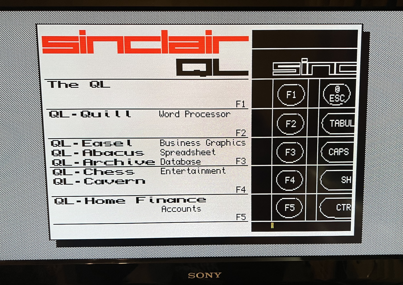

I believe it's an in-store Demo board so I guess Sinclair designed. Each screen is a mock-up with info (rather than the actual programs)
It immediately takes full control of the QL on power up
Posts: 3183
Nice! Heard about those instore demo boards, but never seen a real live example. Thanks for the picture.
