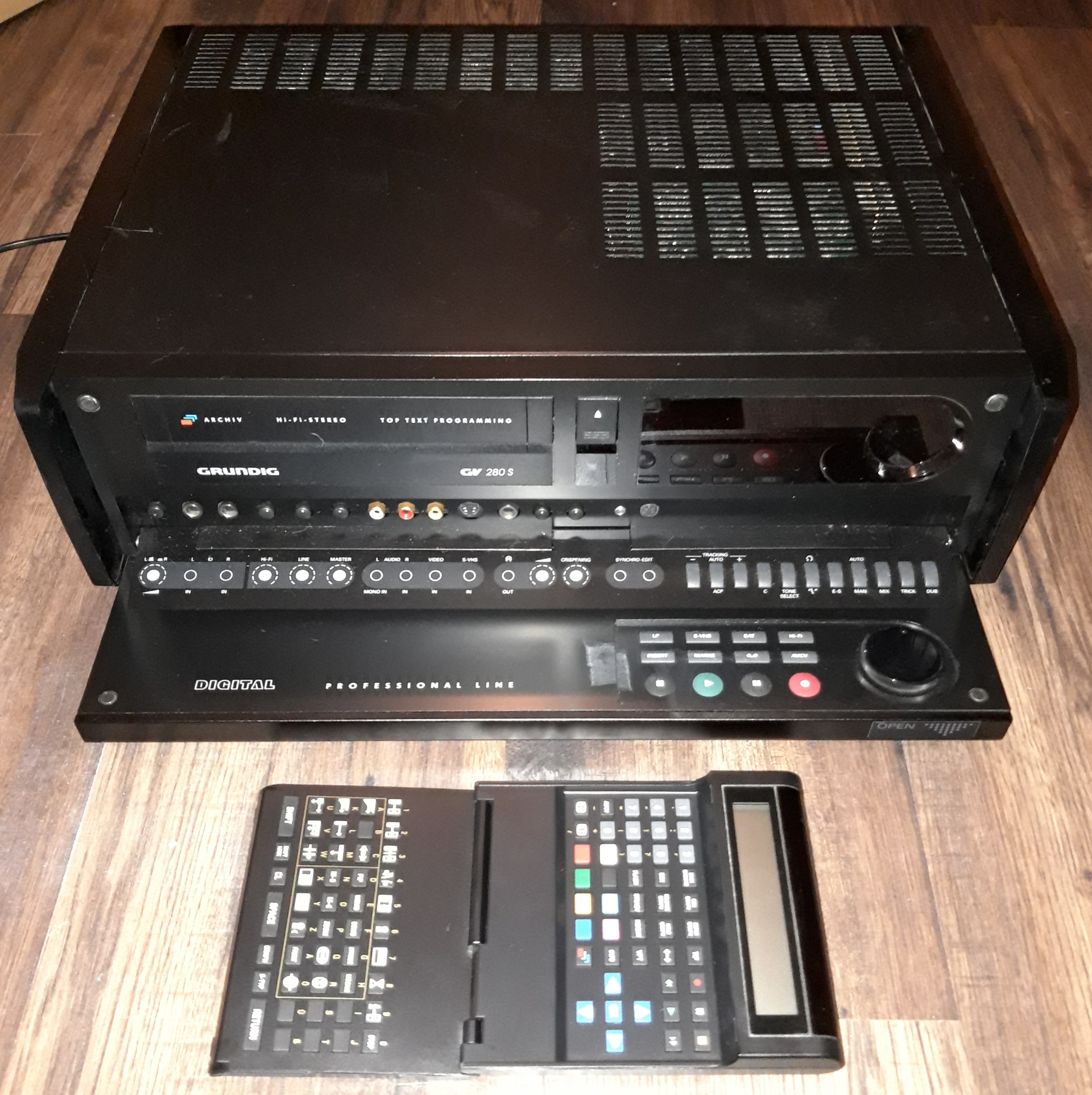

Here is a not very good picture of the beast:
Posts: 1582
Re: PSU Primary side issue (non QL)
I have to say - that's one impressive looking VCR !
And Kudos for getting it all working again - I think mechanically they are as complex as electronically!
