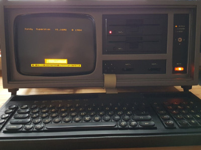

I thought my QL was an oddity. This beats it.
https://www.ebay.es/itm/296234059295?va ... =WHATS_APP
Posts: 3053
Re: My rare old QL version AH
Wow! That's*some* QL!
Posts: 1393
badaman wrote: Mon Feb 19, 2024 4:21 pm I thought my QL was an oddity. This beats it.
How cool is that! Check out the mdv drives in the front panel. Someone really went to town with that one. I wonder what that display/drive unit started life as, some other luggable computer or entirely home made?
I'm always fascinated by QLs with 5.25" drives too, as the use of 5.25" drives was very brief and almost everyone seems to have moved very quickly to 3.5" drives (or skipped 5.25" completely). I have never found evidence of any original software being supplied on 5.25" disks, but of course they would have been just as useful to store your own data on as their smaller brethren.
Edit: just noticed the modified keyboard made of 2 QL tops with added F5 - F10 keys and a number pad! Whoever made that must have spent an awful lot of time on it and was very creative.
