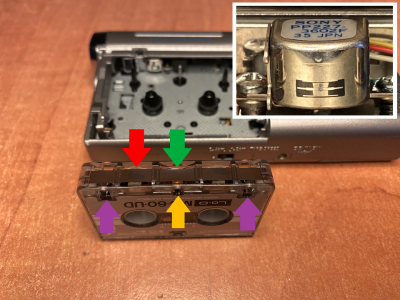

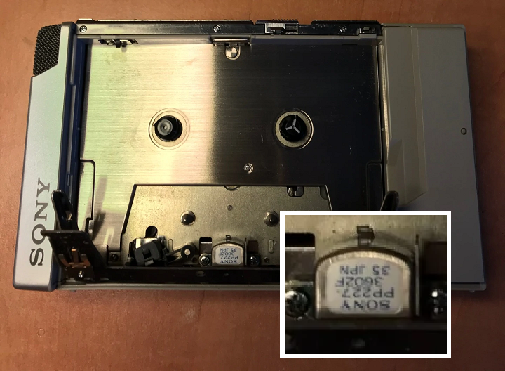

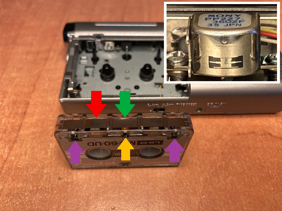

So I looked this up online and found pictures of a normal cassette player (https://www.tapehead.org/en/reparatie/d ... tcs-370-r/) and a micro cassette player (https://www.tapehead.org/en/microcassette-info/) that used the same head. Here I've cut/pasted the closeup of each tape head with the player:
Normal cassette player:
Micro cassette player (the closeup here came from a different picture of the same player):
I did have a spare tape head that was removed from a cassette deck a long time ago, and it measure about 8.1 millimeters. On two of my spare case, it fits in easily on MDV2 and you have to squeeze it in gently into MDV1...these were both UK cases. My US QL is at work so I haven't been able to try it on that. So for some reason, MDV1's opening is slightly smaller. I also have an old Sharp micro cassette recorder and an old telephone answering machine, both packed away in the attic and will find them to measure their head. Hoping that there might be smaller than 8.1 millimeter heads out there.

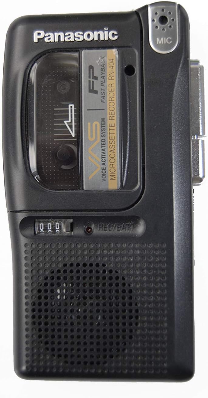

I have a Panasonic micro-cassette recorder https://www.amazon.com/Panasonic-Microc ... 00855ZODA/:
Measured its head an it is only about 5 millimeters, so they do make them smaller. Where to source them though, I don't know.
