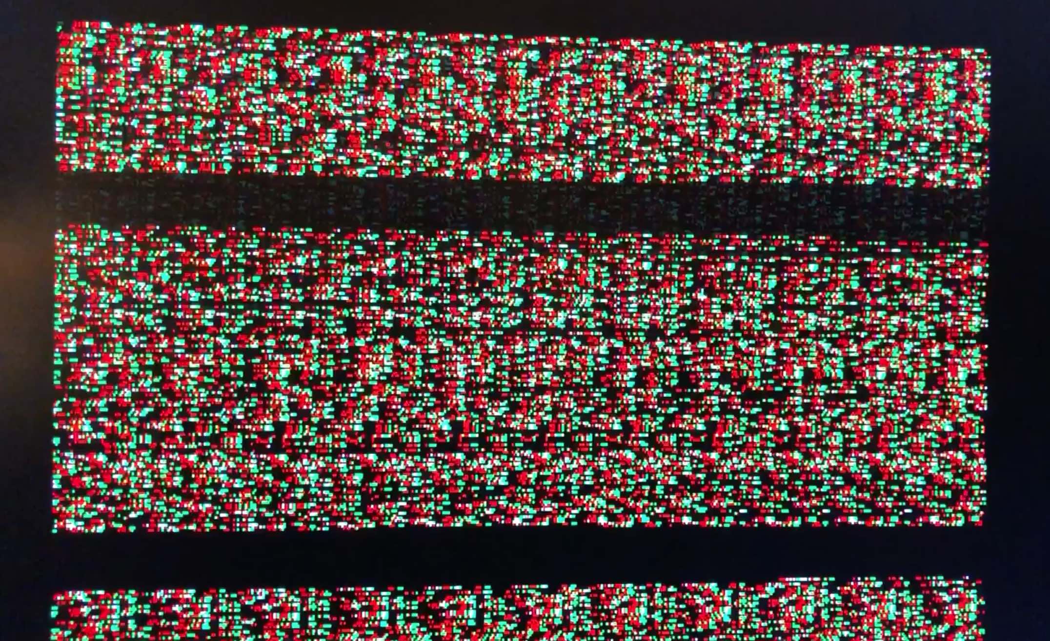

I had some progress so now I have something on my monitor ( see attachment). So my fingers crossed I haven't fried my 8301 they are rare as hens teeth, don't know if I have a problem with CPU/RAM/ROM though...
Cant figure out how to attach a MP4/MOV so will be a screenshot.
Re: Faulty RAM or 8301
I'm assuming the black lines are just related to how the photograph was taken and that you have a solid "tweed" pattern on the screen - does it change at all - or just statically displayed?

Hi
It’s not static, the black stripes moves from top to bottom.
I’m away today but can try to zip a short movie. But the good thing is (I guess) that the 8301 seems to work to some point at least. Yesterday it was blue static but no cursor.

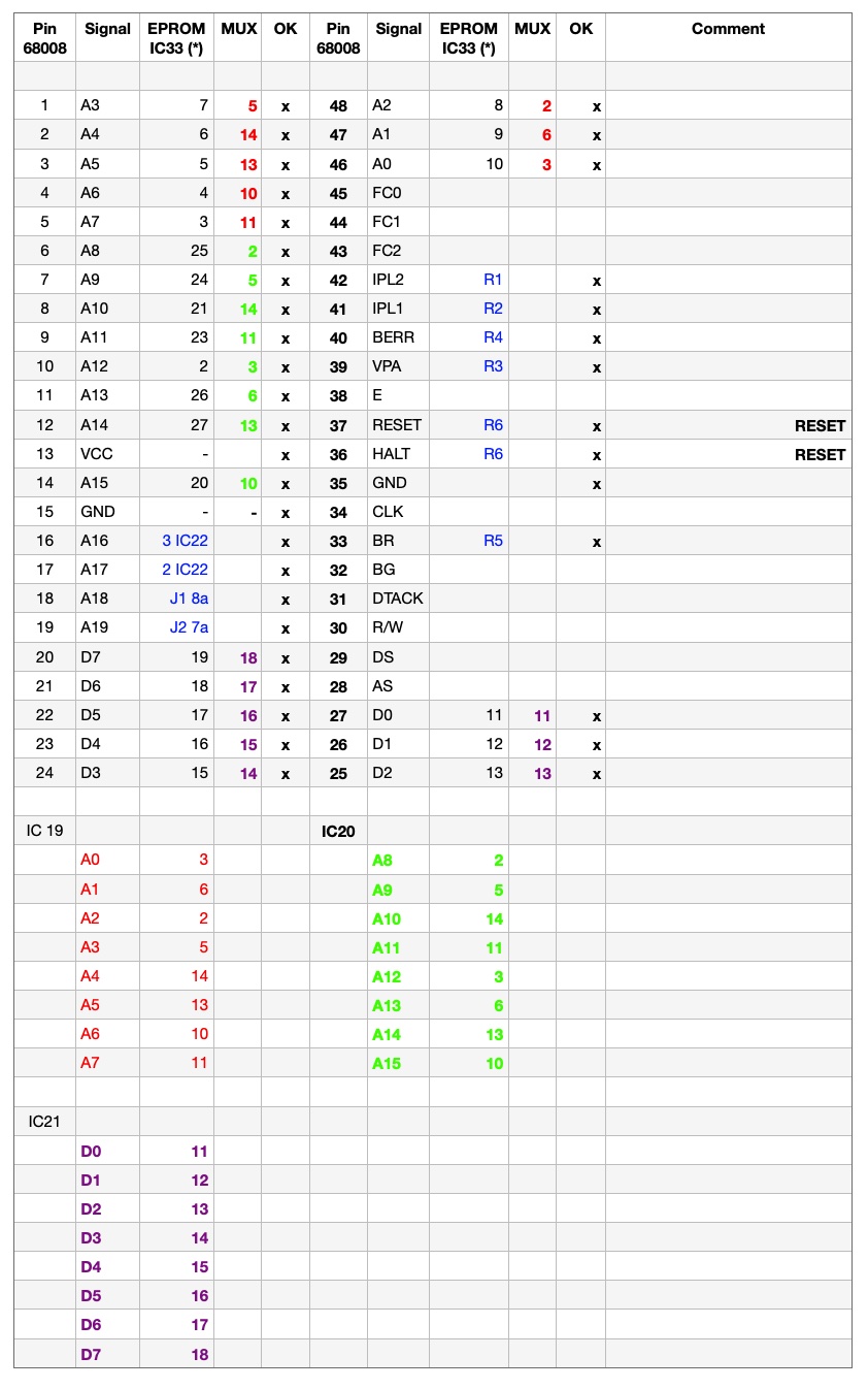

Checked more or less all pins on the CPU, see jpg and all connections as supposed.

The crystal xtal pins will have a sinusoidal wave form, the cpu clock should be more a squarewave - but be careful of your scope settings and probe settings - as these can affect how the scope will see the signal.
Your video shows the tweed pattern ok - so this means the ZX8301 is reading the dynamic RAM - but - the sync is not working - could be the lead / the monitor or the QL
