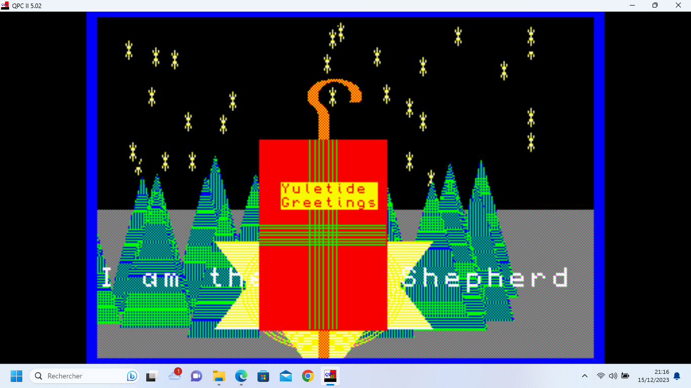

Hi All,
Just a sceen shot...

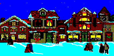

Made some progress. Can you see the blinking Christmas lights?
Small GIF.
So a few more things to tinker with...maybe a shade closing, a room light going on or off inside a building. Then I'll include the zip file with the BASIC and all the sprites.

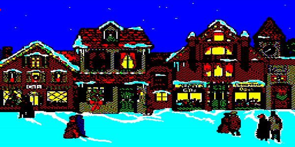

Ok, here is the final version. It has a bunch of random things happening. You have Christmas lights, you have window lights, and you have window shades. Also, the Grinch doesn't always launch all bombs. I also got rid of the weird mouth on the Grinch since it looked bad.
When running it, it will ask for which device, then whether you need to load Turbo Toolkit or if you wan to rerun it (the latter you can do once Turbo Toolkit is loaded).
Grinch.zip
(18.88 KiB) Downloaded 90 times
Here is the zip file.
Here is the small GIF.
Click on this to see the animation.
