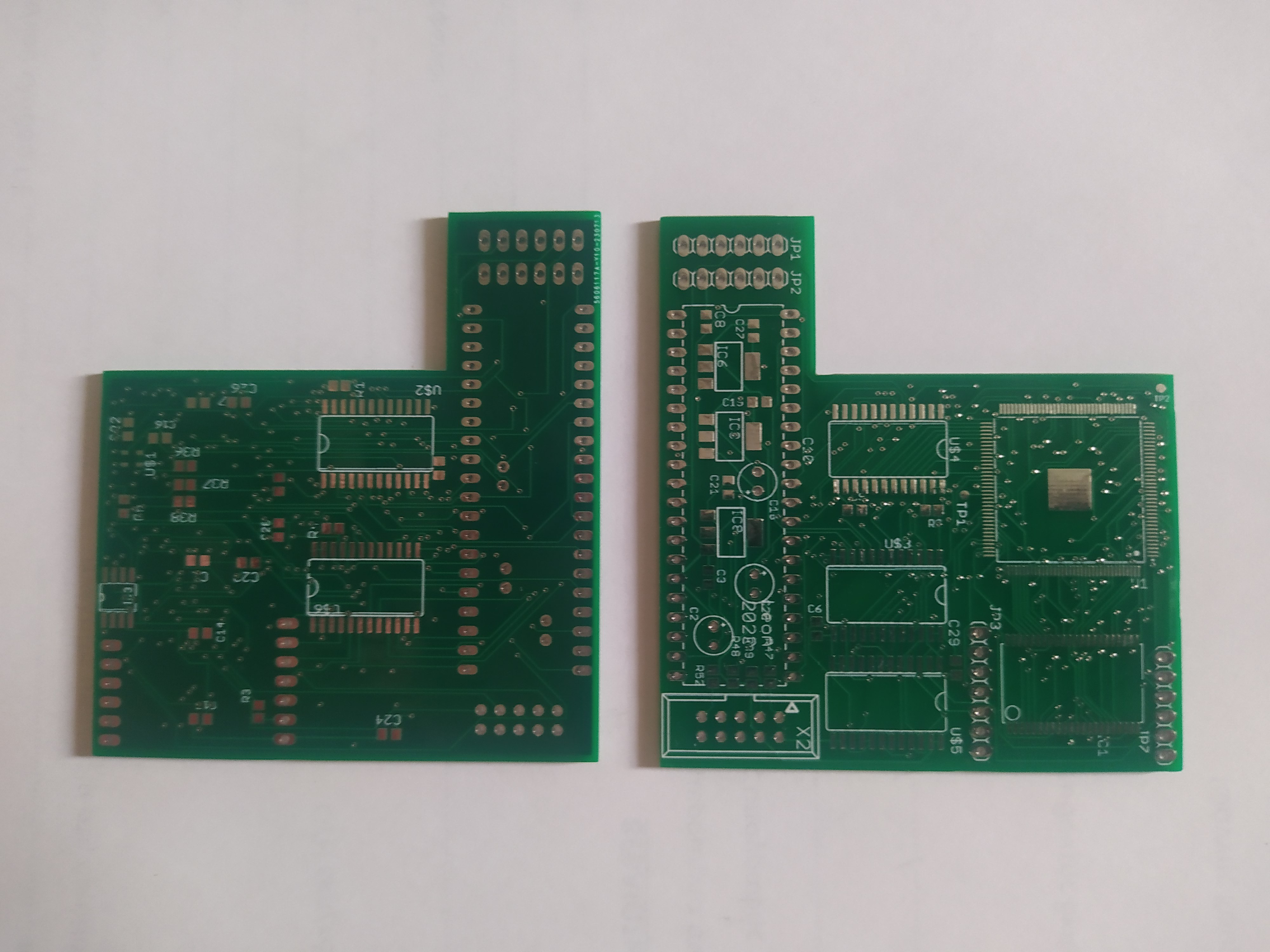

If I am not mistaken the FPGA operates at 3.3V and I notice what seem like buffer chips to convert to 5V QL bus signals?
If so, it might be a good idea to use a 68SEC000 chip on the 3.3V side coupled directly with the CPU and then convert signals that need to go to the QL bus to 5V.
The chip has a statically selectable bus width so can operate like a 68008 but with a 16M address space and full 7 levels of interrupt, though that would not be easily usable in the QL. It would actually be possible to add address lines to the external bus using signals which exist on the 68008 CPU but were never used, like the FC lines and E (the latter was used on the QEP EPROM programmer but that incompatibility is a small price to pay for extra capability). The much lower power consumption is a nice bonus.
One more thing - driving output only lines, eg. address and control lines with 3.3V levels is OK if it's only the on-board CPU driving them. Things get more complex if there is a Gold or Super Gold Card in the picture because it disables the on-board CPU's signals and drives it's own. What is important is that these accelerators drive at 5V levels and while the on-board CPU is disabled, it's pins are still connected to the bus and if it used 3.3V levels and is not 5V tolerant, there will be problems.

Just for info, I buffer and level convert all the lines, input and output. There are 2 more buffer chips under the pcb.Nasta wrote: Thu Aug 31, 2023 3:53 pm One more thing - driving output only lines, eg. address and control lines with 3.3V levels is OK if it's only the on-board CPU driving them. Things get more complex if there is a Gold or Super Gold Card in the picture because it disables the on-board CPU's signals and drives it's own. What is important is that these accelerators drive at 5V levels and while the on-board CPU is disabled, it's pins are still connected to the bus and if it used 3.3V levels and is not 5V tolerant, there will be problems.
And there are two pcb's one for the cpu and the other for the fpga-ram they are independent and the fpga board via cables connect to get A18 to A21 signals + the reset signal and optionally provide a, separate from the ql system, clock to the cpu (I don't use this at the moment and don't know if it can work, I mean run the cpu and zx8301 in higher speed than the zx8302).
Leon
