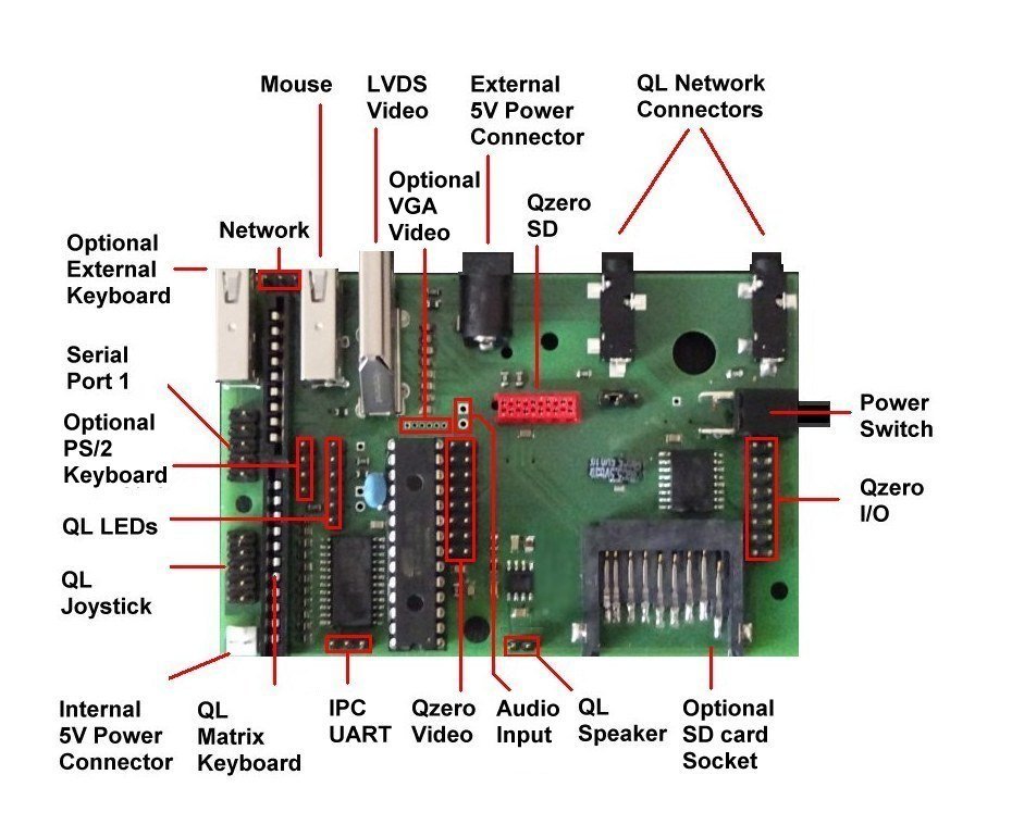

so here were go. QLbase is a little QL Mainboard replacement, mainly meant as an example for other board designs in different form factors etc.
I plan to publish the schematics at some point. At the moment I only provide them privately to friendly tinkerers, to limit the amount of Q&A.
It is a direct fit to the QL case, no case modding. Instead of a 60008+ULAs, it uses a Qzero as compute module. Operating systems Minerva and SMSQ/E.
QLbase has an 8 bit ATmega328P (Arduino compatible) as IPC instead of the QL's 8049. The video output is highcolor LVDS (not to say HDMI). VGA with only 8 colors optional. Supports the QL Matrix keyboard with a direct connection, QL Network at the original QL locations, the QL Speaker, the QL LEDs. The QL Reset button is re-used as power switch. QL Joystick 1 and SER 1 over D-Sub 9 pin connector with ribbon cable. PS2/2 mouse & keyboard as well as buffered realtime clock are also supported.
The connectors named "Qzero video" and "Qzero I/O" are used to plug in a Qzero module. I'm happy if you look at the QLbase schematics and derive your own QL clone from it. But likely that would be something completely different than what you had in mind.

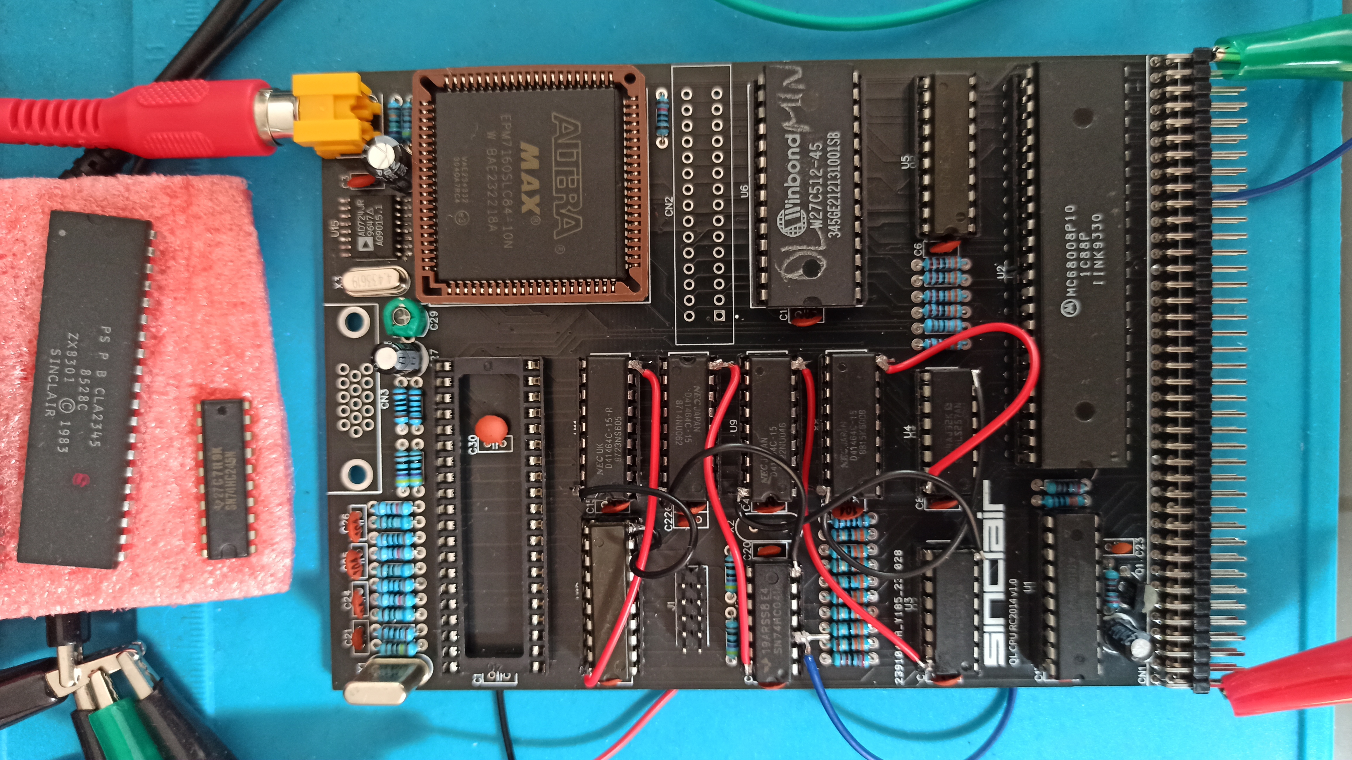

Got the first PCB back for my QL board and populated it. It uses either Lliont's CPLD replacement or the original ZX8301, and 4464s for RAM. A picture of the first version of the board is attached below - and you can see the handful of RAM routing errors (doh!) fixed with jumper wires. CPU, ROM, RAM and display appears to be working. I've not implemented the IO system yet (ZX8302 and IPC clone).
At the moment it initialises to a white screen (JS ROM) or minerva logo (minerva 1.98 ROM). I expect the std ROMs are waiting for the (missing) I/O system to respond before getting to the copyright message/prompt.
The QL service manual seems to indicate the ZX8302 (and possibly the IPC) need to to be working for the system to fully boot. This would provide the std I/O ports, IPC Comms and interrupts missing from my first PCB.
Can anyone give me a steer on the minimum hardware needed for the QL to fully boot (it doesn't have to be useable - yet) ? Or if there is a forgiving test QL ROM available ? I've taken a look at the Minerva source but I'm having trouble understanding the assembler (Z80 is more my thing) so cannot make out what is needed.

The Minerva ram test on power up is quite an aggressive ram test, I was told by the designers once that Minerva test the QL ram and return the best possible ram available, 64K was a lowest value, but whether this works in
practise is another question. Using the RAMFAIL program will give the location of the Internal RAM fault. Whereas with JS or JM etc... ram failures are white screen and the process detailed in the Service Manual by raising the ram data lines high is a way to find the ram fault, maybe not a good way.
Usually when the large red Minerva logo is only displayed on the screen, this usually means failure of the 8049.

Thanks for the detail. Since my last post, I found one of the RAM chips on my design was (eventually) slightly warm and drawing more current than the others. My chips are from Ali so may not have been the best. Now this has been replaced, the system boots up using the JSROM to the copyright/monitor select menu. It's all very encouraging!
The steer on the Minerva ROM is useful. I've deliberately introduced some RAM faults by provided a poor +5V supply to one chip and the ROM displays a three line error code using colour blocks. Once the chip has a solid supply it consistently boots to the red logo in the bottom right of the screen. Having the logo only must (hopefully?) be due to the 8049 failure. I've not implemented this and the 8302 ULA yet.
