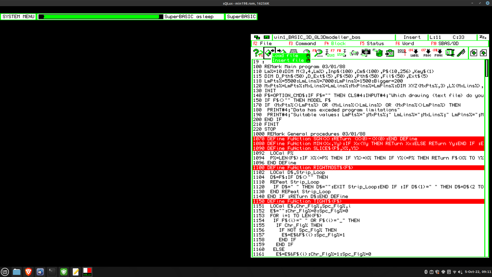

I always thought that a non-SMSQ/E system, would not run WMAN2, but, seems I was mistaken.
I downloaded: PTR_GEN 2.06, WMAN v2.08, HOT_REXT v2.31
I added these files to my sQLux/Q-emulator Minerva v1.98, setup, which loaded the recent versions of QPC2 v1.47, MENU_REXT v8.05, QD 2018-B.07, SYSMON v2.09... so all the same EE applications I use in SMSQ/E, in
My apologies for not keeping up to date.

Re: Where can I find or buy code of MENU_rext
Here is the updated EE with WMAN2 running in sQLux 16Mb, 1024x512 All seems to work nicely.
The only problem I have is getting QD to run Minerva Multibasic

Could that be down to an FI2 configuration issue?Derek_Stewart wrote:Hi,
