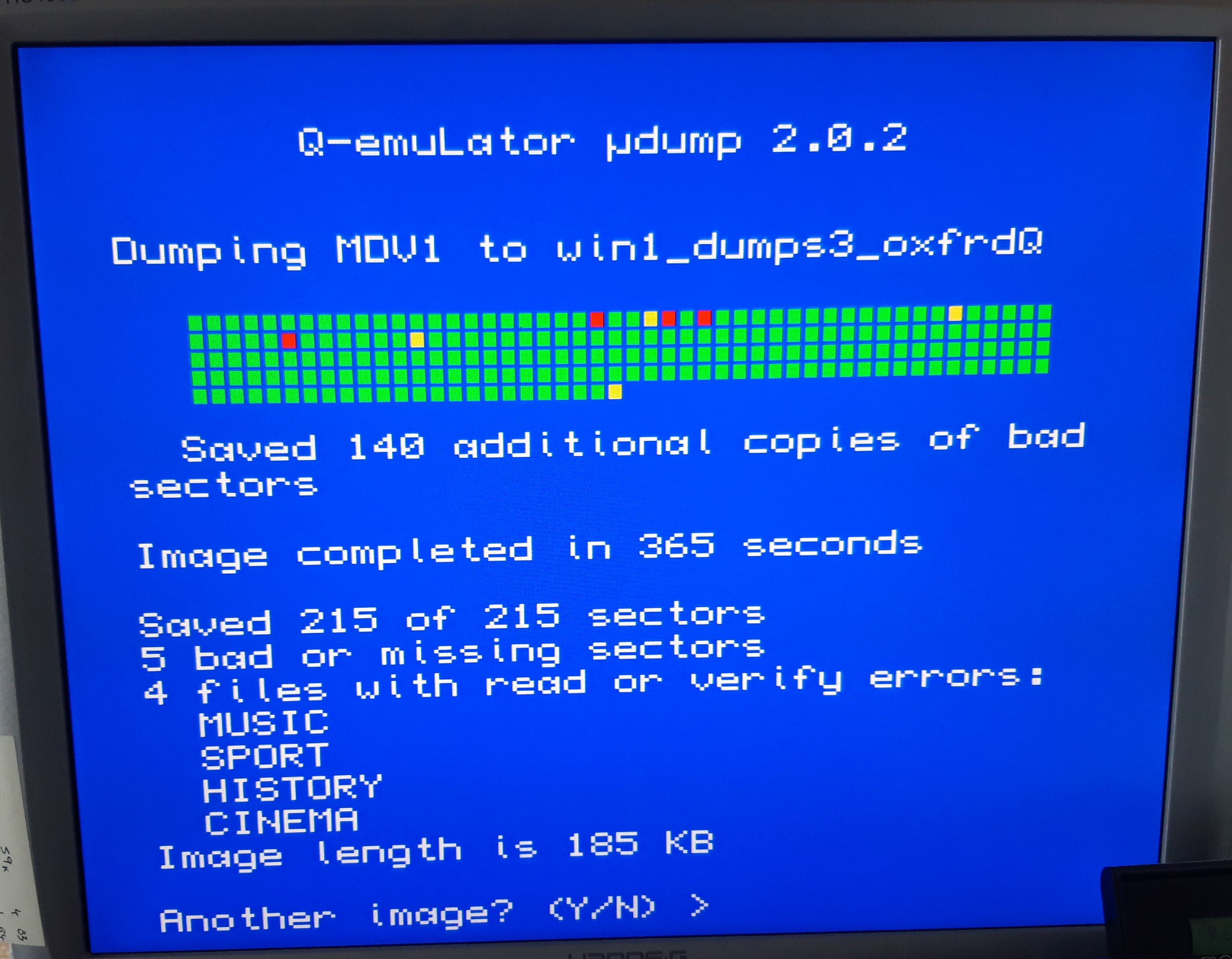

The questions cart could be made up as it certainly includes a lot of categories and I did think that originally it came with just 5 or so. mdump_task reported problems with files MUSIC, SPORT, HISTORY, CINEMA, here's the mdump screen: The question files don't appear to be plain text, looks more complicated than that.

I wonder if the game cart only requires the bad 3 sectors of TRIV_3g_PEXE as reported by Cartridge Dr ($0A, $1A, $3B). Could the 2 missing ones be deliberate?

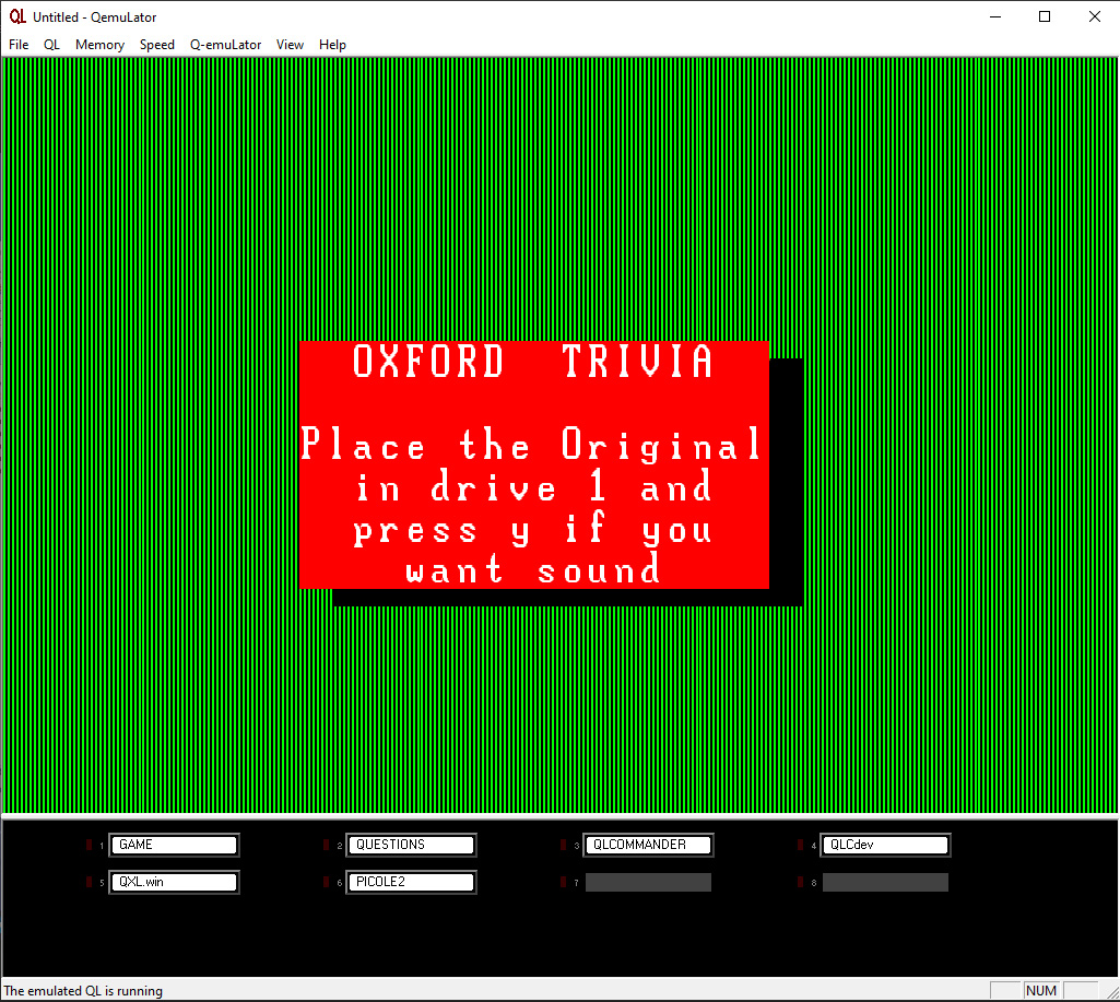

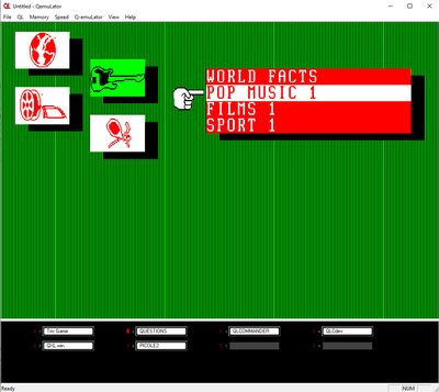

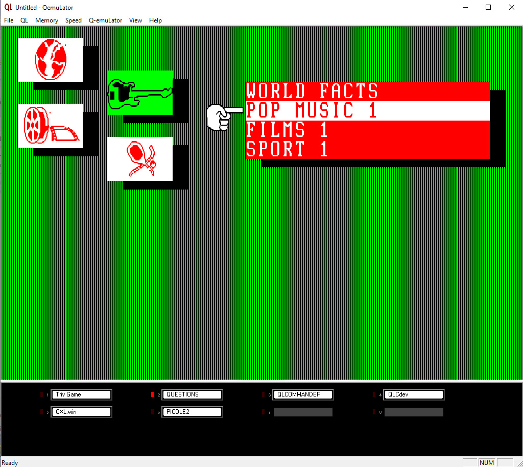

Re: Oxford Trivia corrupt cart fix, Pascal?
I had no time to look at the microdrives at sector level, but I have the game running in QEmulator:Chr$ wrote:I wonder if the game cart only requires the bad 3 sectors of TRIV_3g_PEXE as reported by Cartridge Dr ($0A, $1A, $3B). Could the 2 missing ones be deliberate?
1. Place RWAP copies in mdv1 and mdv2
2. Start QL
3. the screen "Place the Original in drive 1" appears 4. Place Original copy in mdv1. As soon as the original is loaded and you press Y or N the game starts. 5. After game start it makes no difference what cart is in mdv1_
Observations:
1. The Original is labeled "Triv Game" while the RWAP copy is labeled "Game"
2. At step 4 the game does not read or load any game data from the microdrive - it only checks for the existence of the copy protection
3. If you copy anything on Original the copy protection is destroyed - that makes me believe that the copy protection resides in some sectors that are marked as free or it checks the number of free sectors
I am not sure if any of these is of interest

No! I'm sure I tried that particular combination.
Right, having late lunch and will then give it a go.
- Posts: 1401
Yes, that worked for me too!
