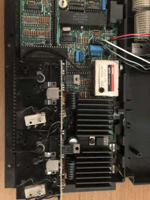

Pr0f wrote:The picture shows the decoding IC for the ROM's is not fitted - you have only a socket, this means the board's wire jumpers
No mention of this so is that a preconfigured jumper block that gets soldered in like a socket but contains shorts for required jumpers?
Is the resistor mod on the top of the chip required or is it different on a series 5 board and fitted somewhere else?
If you look at the picture of the motherboard - between the ROM closest to where the Microdrives would be (bottom ROM socket in the picture - and the empty 14 pin socket - there are positions for 6 jumper wires - currently 3 are fitted as 0 ohm resistors (one single black band). On an issue 5 board, these jumpers in conjuction with an LS logic chip that can (it isn't always fitted) be fitted can allow various combinations of ROM/EPROM to occupy the 2 ROM sockets. The setup shown mirrors what would be present in an issue 6 board - namely 2 identically wired 28 pin ROM sockets - the standard AH, JS, or whatever ROMS are fitted are enabled using opposite logic polarity - so one is enabled when the Address line is low, and one is enabled when the address line is high - the result is that 2 ROMS can be wired in parallel - as only one will be active - this is why you sometimes see stock ROM chips wired piggy back and present in only one socket. You can treat the sockets as identical. This means Minerva on the carrier board will work in either socket.
I suspect the issue you are facing is related to the vDrive and Microdrive wiring and some interference between them. Do you have pictures of that end of the board - showing how the vDrive is connected?

Pr0f wrote:If you look at the picture of the motherboard - between the ROM closest to where the Microdrives would be (bottom ROM socket in the picture - and the empty 14 pin socket
Thanks. I was confused by the odd looking empty socket that my issue 6 doesn't have. :? If the board is rigged as an issue 6 ROM system does it mean the RAW line resistors are fitted somewhere else instead of on top and soldered to the pins of the 40 pin chip?
Posts: 1558
Re: Problems with/after ROM replacement, vDrive and Exapanderam
The board itself is issue 5 - so that BIAS resistor fix is still needed - as the resistors are not elsewhere on the board. The service manual - available on Dilwyn's site - has a list of all the mandatory modifications I believe.

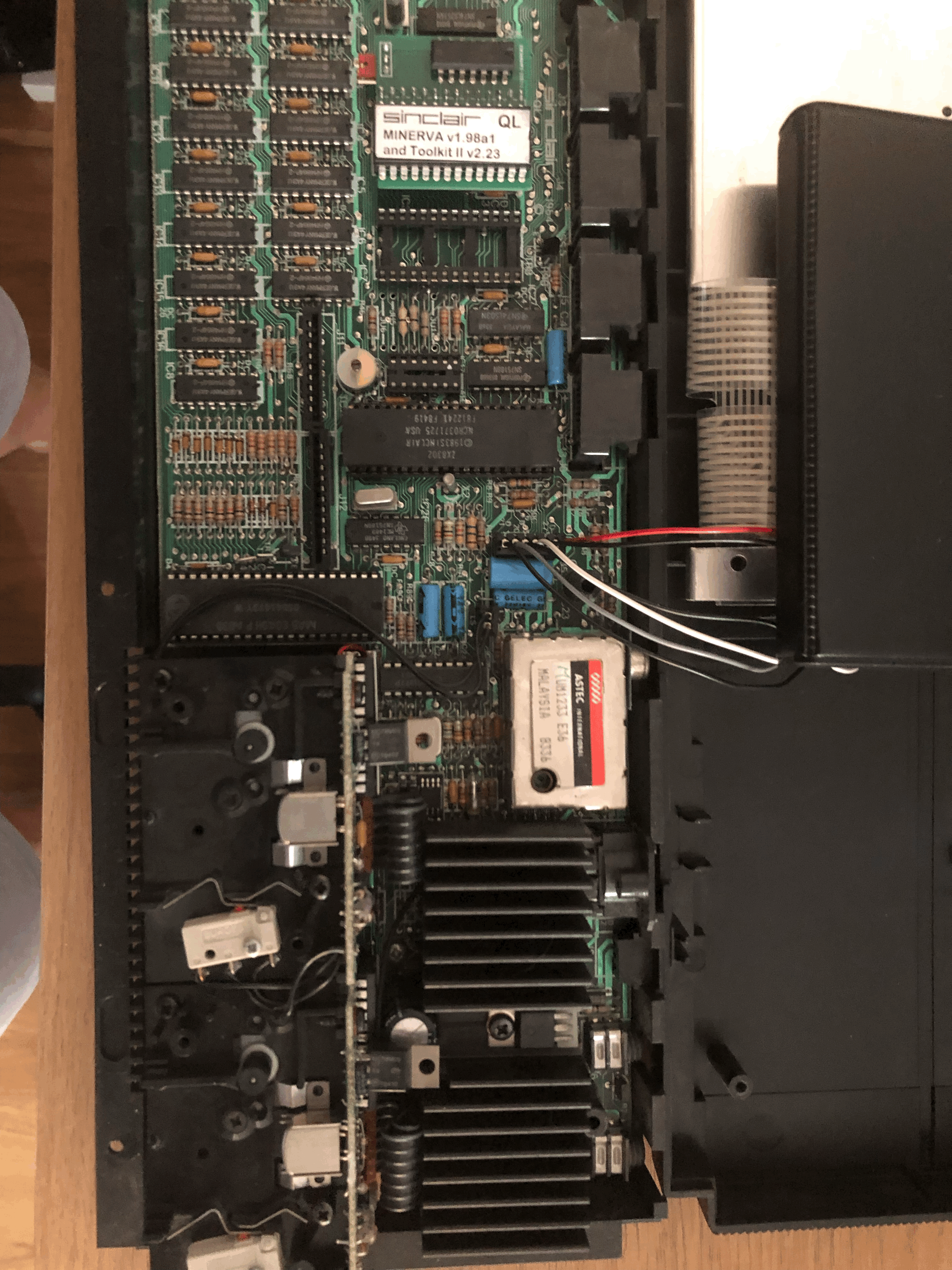

Yes of course, here is the picture of microdrives and vMap. Let me know if you need a zoom of any item.
Posts: 4693
Can you check that the vMap and Microdrives is installed correctly.
Try accessing the vDrive without the vMap installed, you will need both microdrives installed to establish the link from the 8302 to the external Microdrive connector.
Or without micrdrives installed, connect a link wire from MDV1 connector Pin 1 to MDV2 connector Pin 2, to link the connection from ZX8302 MDSELDN, pin 34 to 4A on the microdrive external connection. The vDrive can only access MDV3-8 without vMap.
Its seems that the MDSELDN line goes in a serial line of:
8302_pin 34 ---> MDV1_Pin 1---> MDV1_Pin2---> MDV2_Pin1 ---> MDV2_Pin2 ----> EC1_Pin 4A
