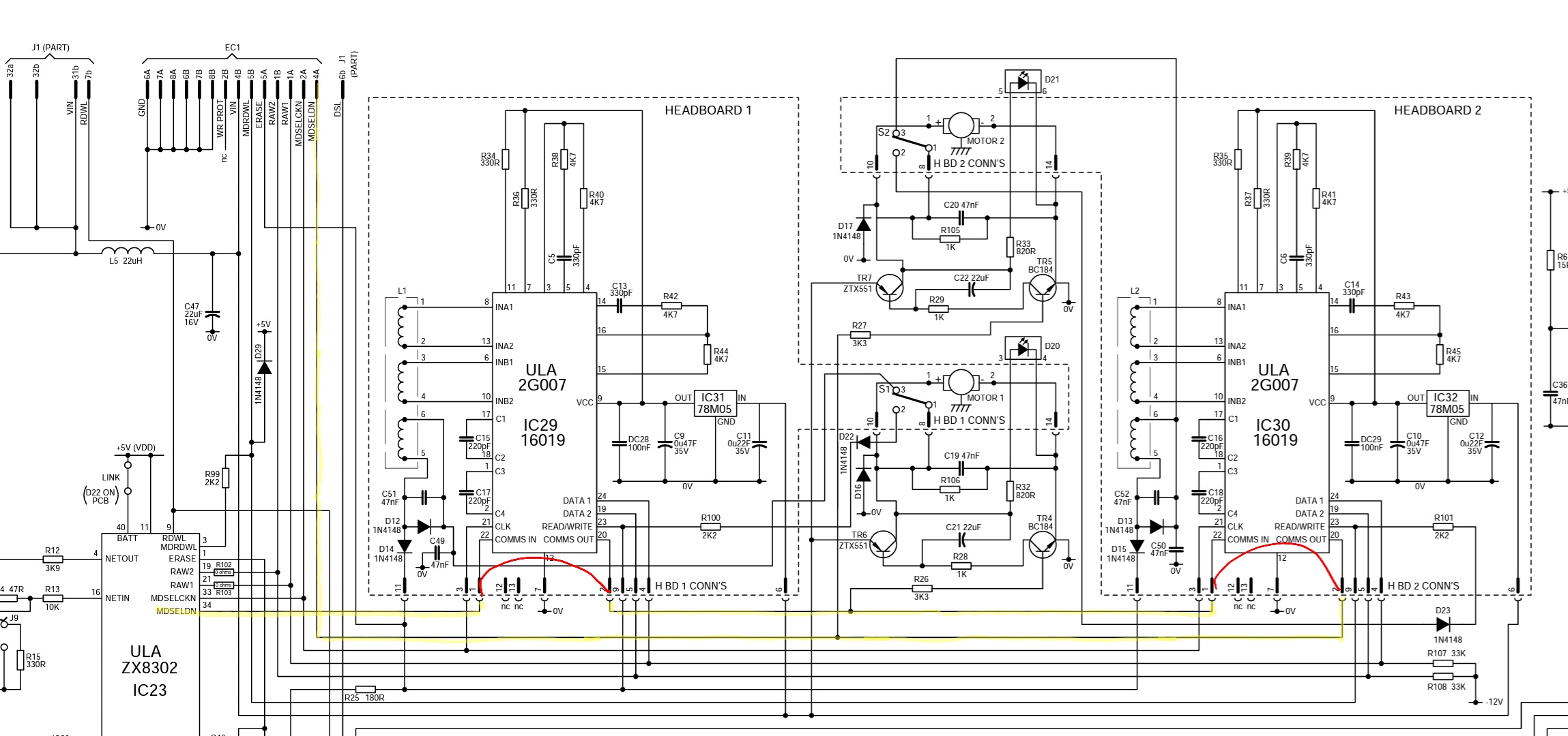

xelalex wrote:Hi Ernesto,
could you run the OqtaDrive daemon with debug log level and do a dir mdv1_ or a load and post the log here or send via PM? Maybe we can infer something from that.
And to clarify, you have OqtaDrive connected to the external connector, removed the internal drives, and bridged COMMS IN to COMMS OUT in both internal drive connectors?
If you haven't done already, also set DRIVE_OFFSET_QL to 0 in oqtadrive.ino, just to rule out that automatic offset detection is misbehaving.
Alex

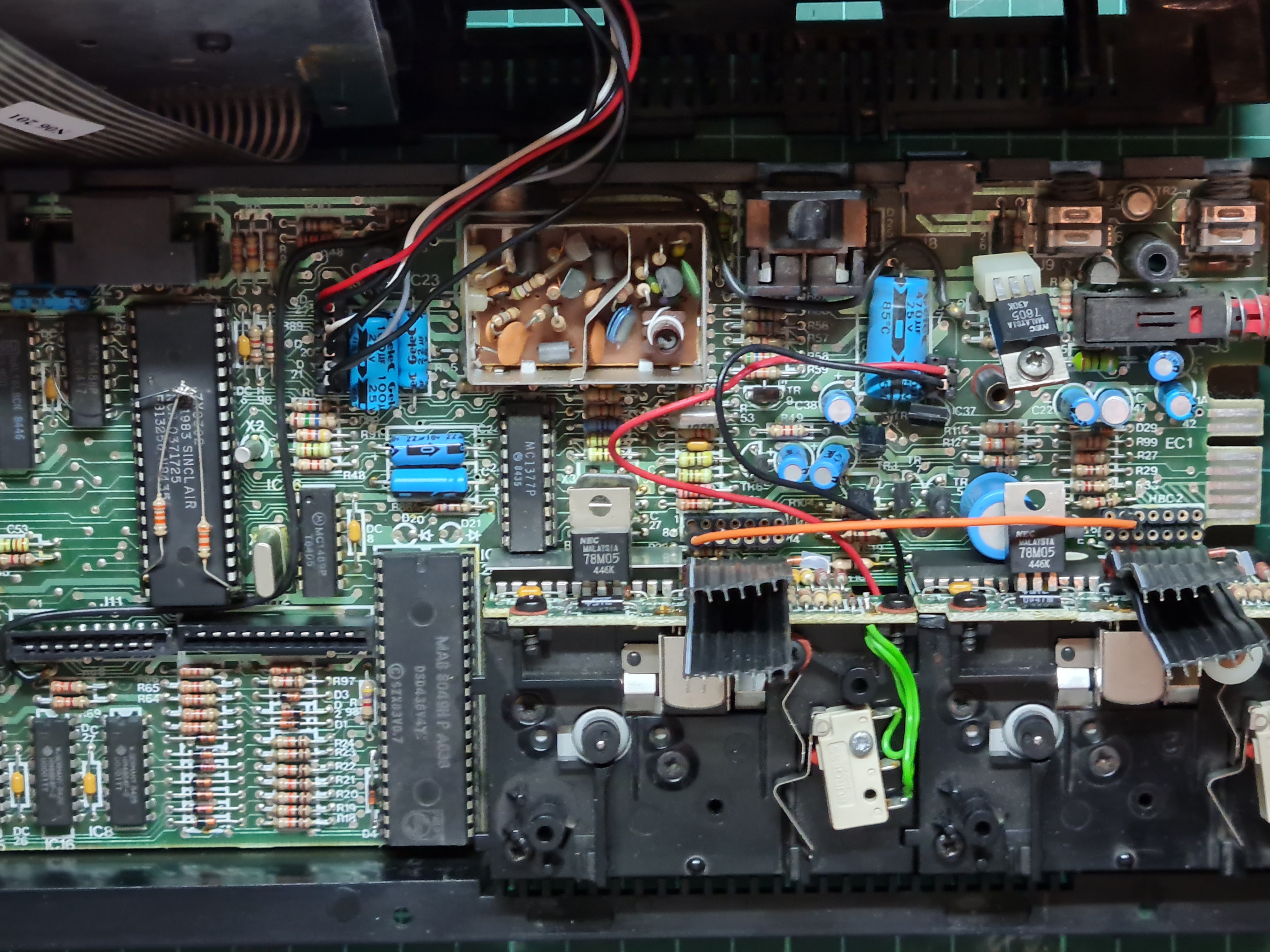

Well there you have it..
The orange wire from conector mdv1 pin1 to conector mdv2 pin 2 re-established the connection from ZX8302 pin 34 to 4A on the microdrive external connection.
Also checked for continuity from pins 19 and 21( the one previously bended) to 1B and 1A ...
And
It worked!!! :P
It was easier than I thought thanks to your gide!!!!

Cool! 8-) Happy to see it working. I'll add a note to the project README, that points out the need to bridge the two pins when removing drives from a QL.

Without the bridge, the drive daisy chain is broken, and nothing would work, be at OqtaDrive or an external real drive. For example, if you remove MDV1 from the QL and don't bridge pins 1 and 2 in its PCB socket, MDV2 will stop working.

I think the link just moves the Current Microdrive train 'closer' to the Zx8302
So if you bridge the link in the header for MDV1 - MDV2 will actually become MDV1 - if you bridge MDV2 as well - then MDV1 will be the first external drive. The select signal just gets clocked through available devices.

Whithout the links MDSELDN won't reach the edge connector. At first I used a long wire from mdv1 IN to mdv2 OUT. The I realized that this way, mdv1 led indicator was skipped...
