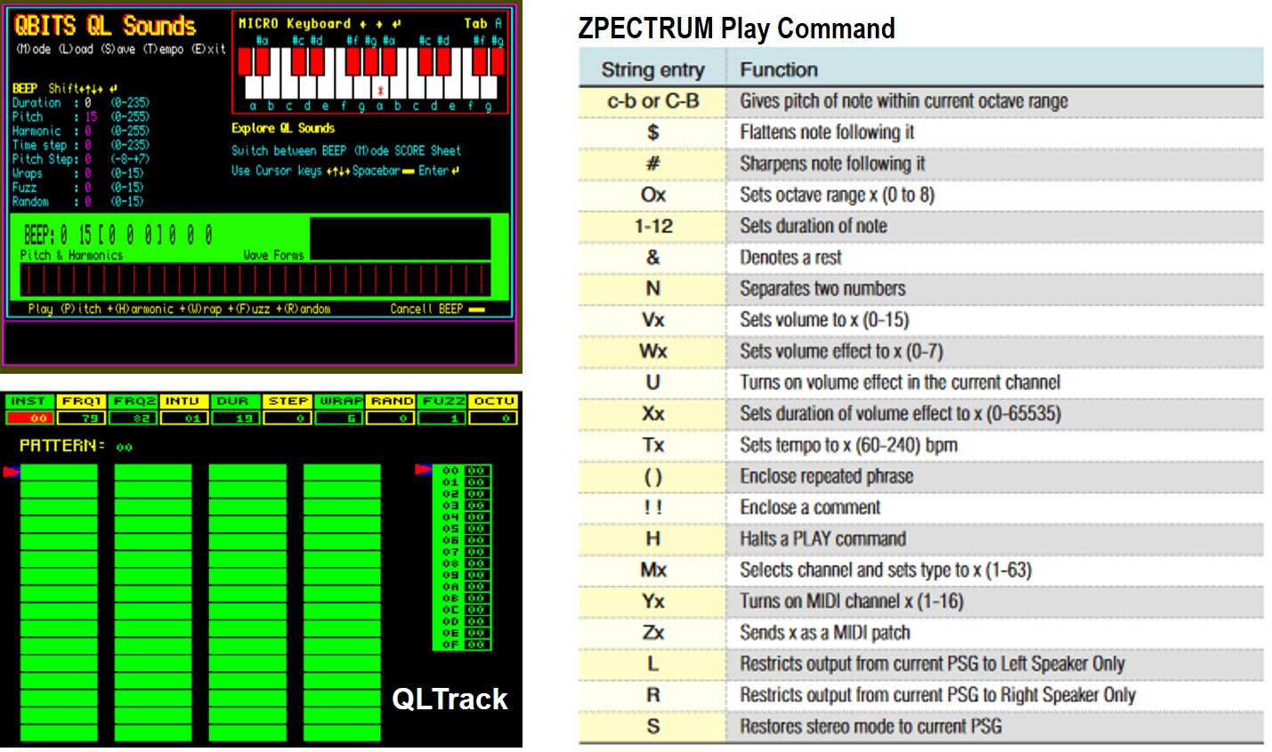

Before now, I thought I would never see a music tracker running on a real QL 8-)
It's very promising!
Some comments:
- it crashes with SuperGoldCard (not a problem for me)
- at least one note is out of tune (probably the FA)
- the cursor leaves blue squares on black background (not a real problem indeed)
Please go on with this innovative project. I offer my help, for the little that I am able to do

If we are talking about Music trackers which act as music sequencer software for creating musical scores groups of notes. I have thought about extending the QBITS QLSounds BEEP and SCORE modes screen layout to include a more versatile Digital Synthesizer/MIDI Format editor.
Unfortunately, QL Beep Attributes I assume to the best of my knowledge generate a 16bit digital code and used with single transistor as a primitive form of Digital Analogue Conversion to energise the internal speaker. To create a digital coded output 24bit or 32Bit the latter better for MIDI recordings this will require a serial port outputting to a more versatile DAC device.
Note: Zpectrum Next has a Beep command but also enhanced sounds with a Play command deploying 3 Programmable sound Generators and various attributes.
Spkr it’s good to have more interest in QL Sounds. Some documentation on your Prog would help to explain your aims and its command handling.

Thanks for the kind words, and the feedback its much appreciated!
With regards to the tones out of tune; the QL frequency tab is quite bad when mapping to actual notes. So the current keys are an APPROXIMATION to the best mapping QL has to offer....
With regards tot he supergoldcard; the software is targetted for black box ql, so the rest is... Well, both expected and unexpected :) ?
Im aware of the visual impediments it currently has. Im usually function over form, but noted!

Hi QBITS
thank you for your kind words and feedback. I must say that some (all?!) of my code is based on your documentation combined with some testing around and whatnot. Thanks so much for meticulously describing your process, FUQL wouldnt have been developed as fast as if it werent for you!
The goal and aim for FUQL are simple. It is a tool primarily made for musician(s) to compose music to accompany democode that I want to release. As such, design choices are influenced by his/their feedback.
As for me, my goals are very much focused on what I want to achieve myself, and for FUQLTrack this does not involve documenting the tracker. In a sense, documentation would impose upkeep and drag for me; and Id rather just spend my time on developing.
However, I believe in free information and openness, and put the code to a public repository and have people find what they need from the codebase. And Im generally responsive to questions and/or chats on irc ;P

Hi Wietze
When I suggested more documentation, a note on the screen labels and what other keys cursors etc are used for interaction would be helpful.
I assume the top row uses the BEEP Attributes but what is OCTU for?
INST Instrument? 1 to 255
FREQ1 Pitch_1
FREQ2 Pitch_2
INTU Time Interval
DUR Duration
STEP Step Intervals
WRAP Wraps
RAND Randomness
FUZZ Fuzziness
OCTU ?
PATTERN each number I assume relates to the screen grid shown with 16 rows and 4 columns/Channels for different Notes/Instruments.
The screen column on the right 00 to OF are these Frames or possibly Amplitude Settings for each row?
For now, running your code on both of my emulators just freezes the screen! The Debugger ??? 000001D4: bsr.s pc+222 ; Src:$2B2 ???

Hi qbits,
Octave is the Octave selection for the 2 active Octave from the keyboard interface.
The tab on the right is to sequence the patterns in succession. The active pattern can be changed by pressing the - and +, which alters the pattern under edit.
Pressing enter will play the sequence from start.
I found out that the code has some construct that works on the real machine, but not on all emulators or so. I will link an updated piece of code to see if that fixes your issue.
