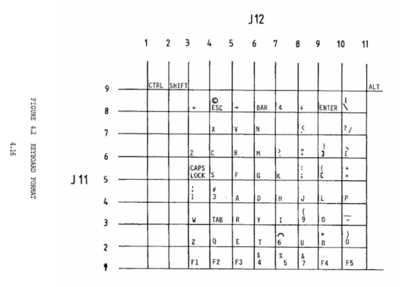

It is an 8x8 matrix, thus 64 keys (mind the double shift keys!). However, shift, ctrl and alt are treated with extra diodes because there are some limitations to what keys can be pressed without 'phantom' keypresses being generated. Won't go into why here, suffice to say shift-ctrl-alt can be pressed together in any combination, and 3 keys pressed together can, without separate diodes inserted into the matrix, generate phantom keys - therefore shift-ctrl-alt have special treatment, each with it's own diode.
Posts: 1604
Re: USB Keyboard IF

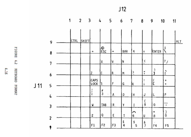

Sorry, I'm a dunce. I saw the 9 and 11 line on a keyboard membrane and googled to find this image and never actually looked at it. 1 row and 3 columns only have shift, ctrl, and alt and there are three empty slots in the middle's 8x8 so 64 total. Makes sense now.
Posts: 1604
Re: USB Keyboard IF
Maskenlos wrote:I just counted the keys on my QL, if not miss-count there are 65 keys. Could anyone kindly double confirm :D
To be honest, there are no keys missing, even better, there are keys on the PC Keyboard which not even exist on the QL keyboard:

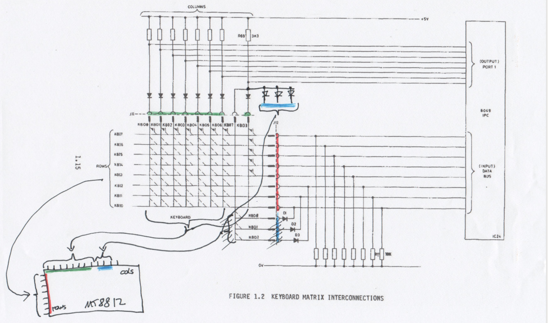

Also its a mystery that the QL has a 9x11 Matrix, the 8049 IPC only supports 8x8 Matrix. Kindly check the diagram below. So a MT8812 and 3 external diodes will do the job. 8 & 9 ribbon cable are correct, as I do not use pins 1,2 & 11 from J12.

I don't expect any problems with CTRL, ALT, and SHIFT & their combinations, because Spectratur hooks directly into the QL's keyboard matrix. Activating a switch in the MT88xx switch matrix is pretty much identical to pressing a real key. So should be fine, but Stephan will report.

I discussed the special keys of the QL keyboard with Stephan before he set out to build this. I came up with a solution that replicates the original, using three diodes. You can see them in the breadboard picture Stephan posted at the top of this thread. I'm sure he'll draw up a schematic once he's done ;)

Find attached schematics from Alex how to connect MT8812 with 3 additional diodes.
In addition A5 from Arduino must be connected to AX3 from MT8812. The rest of the setup as shown on the Github page from Alex.
