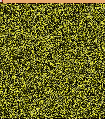

Hi Folks,
The question asked was : Is the program TRUE random ? In order to answer, I wrote a program to test the QL's RND(0 to 1) code.
If the RND(1) code is truly random, the picture should be mostly full of mush. But straight coloured lines reveal any repeated digits...
But as the rand31(mn,mx) routine acts on individual bits in constructing the random number, this slight bias is diluted considerably.
So, I suppose that the rand31() code produces better random numbers than QL ROM, (except for rand31(0,1) ! )
I hope you find the rand31() program useful ?
Steve.

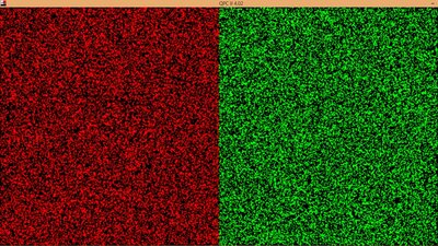

Hi again,
The previous screen was a test on bias. This one simply shows rand31(0 to 1) on the left, and rnd(1) on the right.
Can you spot any difference ?
Steve.

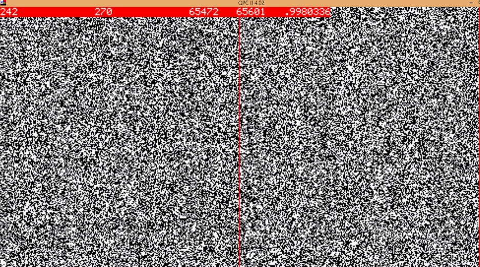

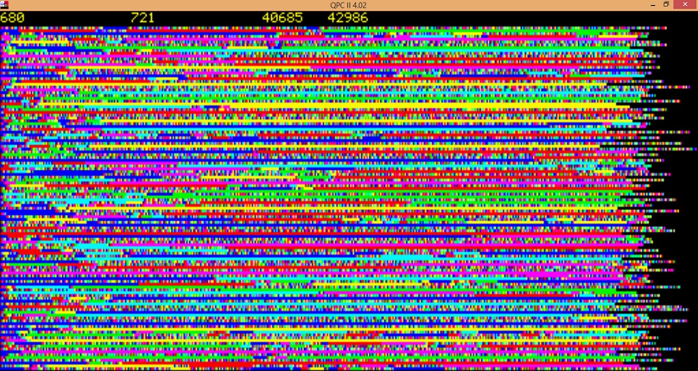

Post by stevepoole »
Screens 1: rand31(0,32767) on left, rnd(32767) on right.
Screen 2: rand(0; (2^31)-1)
All seem Ok.
Steve.
_________________
