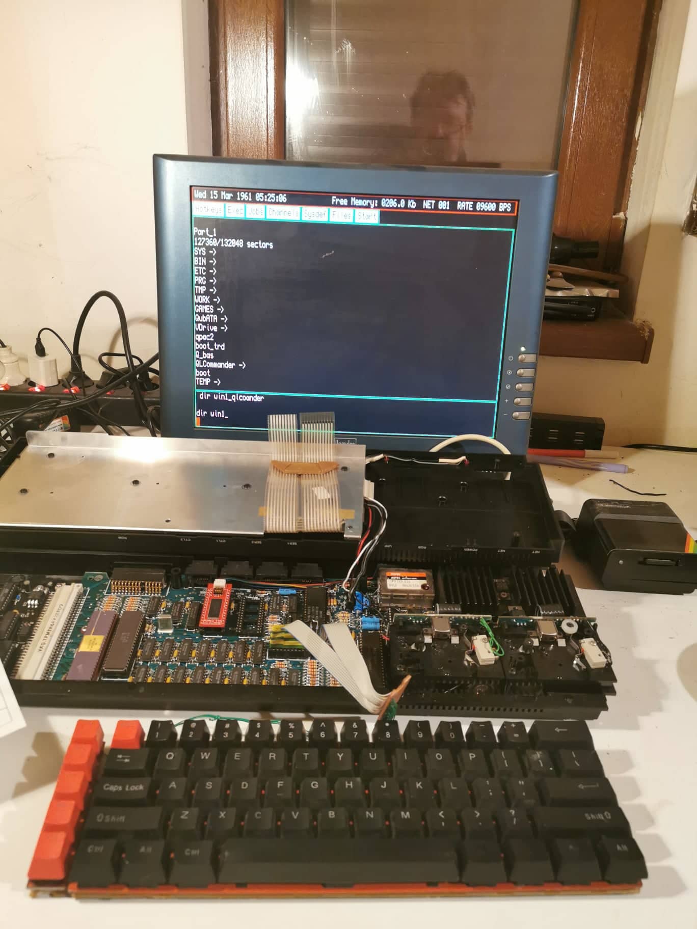

Posts: 1048
Re: DIY keyboard
Still have a lot to do, but at last the keyboard is working.
I'm not happy with the keyboard connectors, so I'll have to build new ones.
And not happy with decals I bought for the keyboard - if anyone knows where to buy some decals with large arrows, QL style, please let me know.
