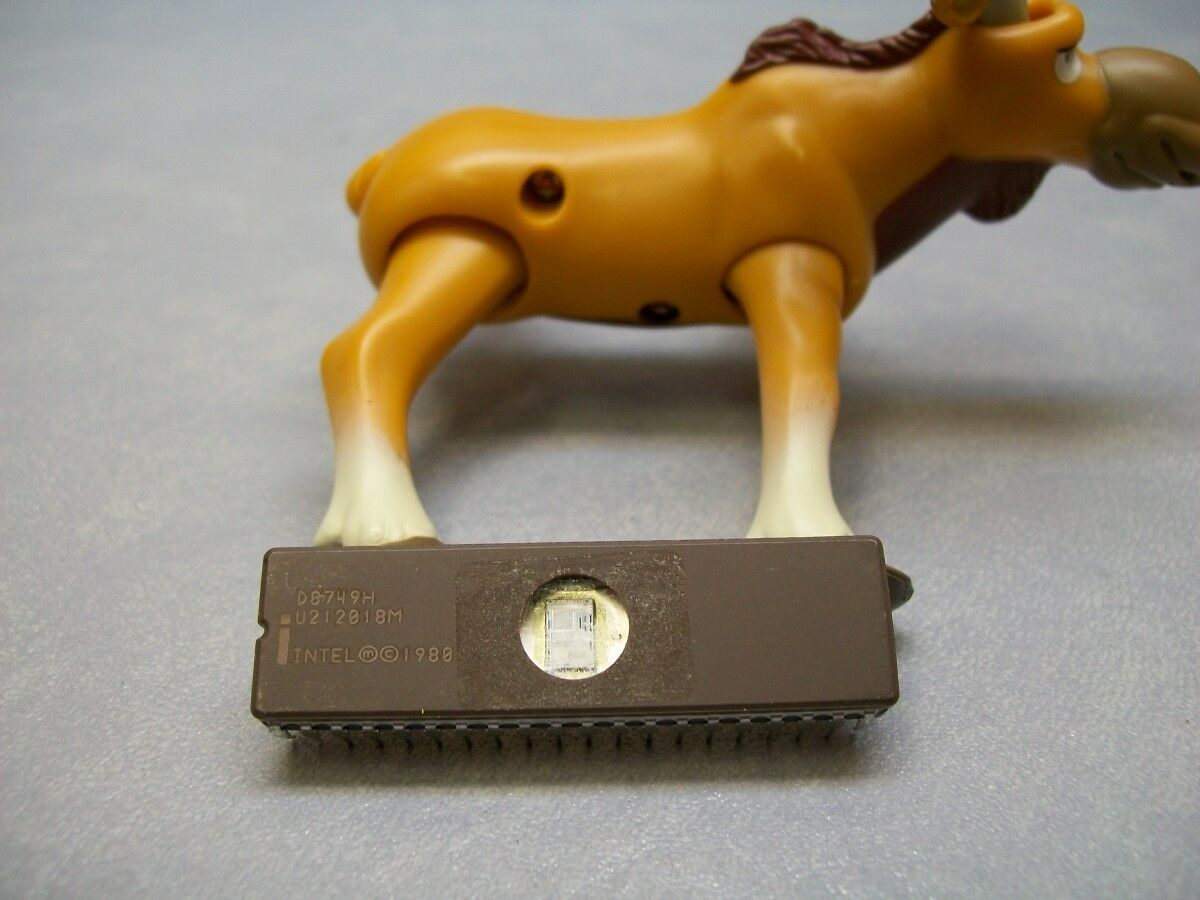

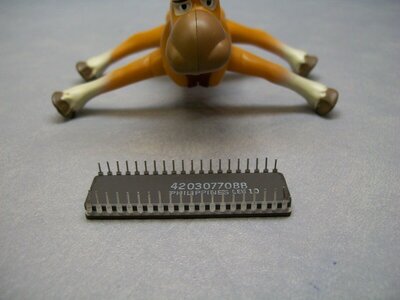

Posts: 4756
Re: Hermes status
I could get some 8749 from UTSource for £6-£8 depending on quantity.
But I saw this on eBay:
Priced at £52.07, from the USA, a bit expensive, but the extra safety device probably bumps the price up.
