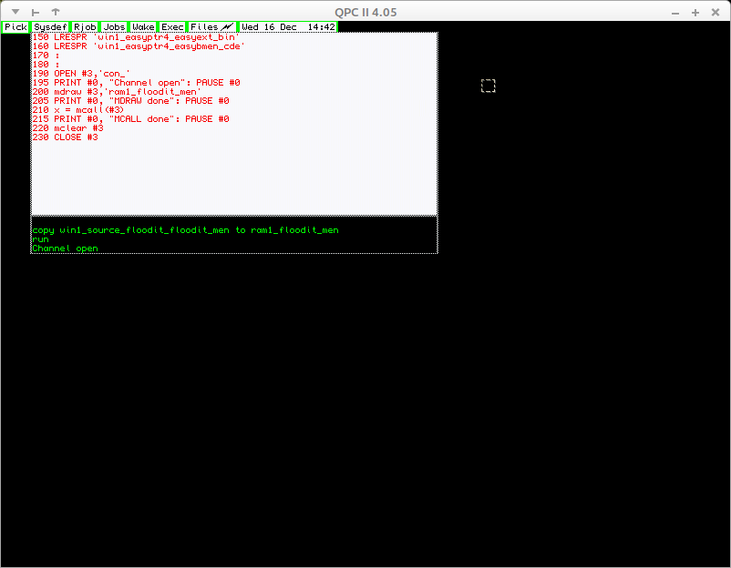

Hi Marcel,
could you please do me a favour, when/if you get time.
I've created a menu in Easyptr4 with the sprites loaded from an _msc file. When I MDRAW it, it simply hangs SBASIC whether in job 0 or a daughter job.
I then erased the menu, and created a default one - that too has the same problems.
I'm using this sort of code:
open #3,'con_'
mdraw #3,'win1_source_myApp_myMenu_men'
At the point of MDRAWing the menu, lockup ensues.
Are you seeing the same thing? This is on QPC2 by the way. Same thing happens if I load and initialise QMON2 before MDRAWing -- no exeptions from QMON2, so I'm assuming that the job has gon into hyperspace.
Thanks.

Posts: 2483
Re: EasySprite problems.
Hi Marcel,
Ok, I wiped my hard drive's installation of EasyPtr4, then re extracted everything from the latest version from your web site. I still get hung when I attempt to MDRAW any menus. Screen shot of a test run from a fresh reboot of QPC. Nothing loaded except what you see onscreen (plus TK2 etc as per default startup.)
QPC is reporting as "QPC II 4.05" on the task bar. This is on Linux under Wine, which has been working up until the latest download. Much as I always hate saying that sort of thing. :(

Norm, try loading ptrmen_cde instead of easybmen_cde

When I saved the menu, I clicked the '8' option to save for mode 8. Mainly because it's intended for a mode 8 program. If I save it as '4' for mode 4, it works fine. if I put the system into mode 8, then save it as mode 8, it still fails. So there appears to be a problem saving with the '8' selected -- when running QPC in High Colour mode perhaps? That's the mode I'm using and It doesn't seem to change when I run "mode 8" commands.

Good lord, mode 8? Why??? In that case it is sort-of expected, I guess. It tries to switch the machine to mode 8, which fails as you cannot switch a high-colour screen to mode 8, so it hangs in an endless loop.
