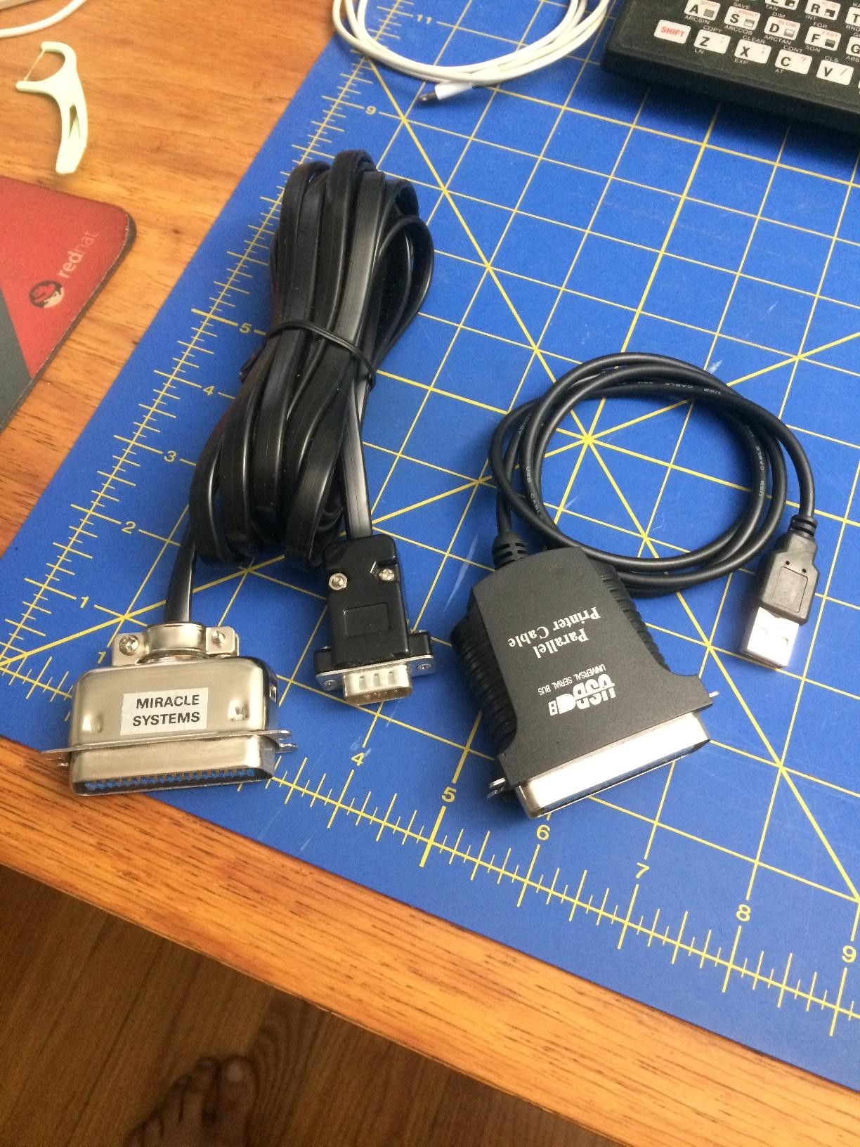

I have a US Miracle Centronics Interface. It looks different:
Oh, I have a USB one next to it that I bought a few years ago when I upgraded my desktop and still had an old parallel laser printer.

Hi,bwinkel67 wrote:I have a US Miracle Centronics Interface. It looks different:
The Miracle Serial to Parallel interface is not a specific US marketed interface.
This was the next version, in the Miracle Interface, I have one in use , but has a QL connector , rather than a DB9 connector.
The new interface was a major change in the way the converter was made.
I remember organising a QL Show in the North East of England, in the 1990s, where Stuart Honeyball wanting lots of publicity to promote this new product.

Very compact design. I'll have to take a peek inside of it at one point.Derek_Stewart wrote: This was the next version, in the Miracle Interface, I have one in use , but has a QL connector , rather than a DB9 connector.
