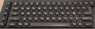

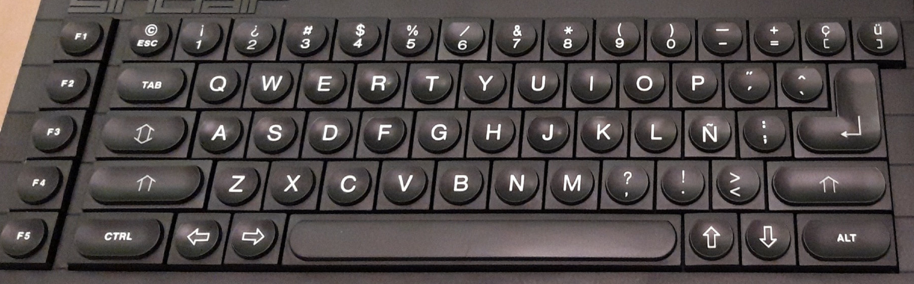

afx wrote:How can I help you to solve the problem?
Please post a picture of a Spanish QL keyboard, I cannot find one anywhere on the web.

Posts: 1400
Re: SMSQ/E 3.36
I can do that!

Cool, thanks. afx, you can try patching the 3.36 binary this way
s$ = "win1_gold"
l = FLEN(\s$)
IF l <> 237836 THEN PRINT "Wrong size": STOP
a = ALCHP(l)
LBYTES s$,a
POKE a+$F563,$4E
SBYTES_O s$,a
RECHP a
The Q68 version is fine I supposed?

Hi Marcel, great!!
Now with the patch the accented vowels (áéíóú) work well!. (¡Bravo! :D )
There's just one small problem left:
- The single quote key ( ' ) is not on the spanish BBQL keyboard, this single quote must be produced by the CTRL key and acent key ( ´ ) (the key to the right of the P in lowercase). The version 3.36 not patched does this well.
mk79 wrote:The Q68 version is fine I supposed?
Yes, In the Q68 SMSQE version 3.36, the Spanish keyboard layout and messages are perfect.
Chr$ wrote:I can do that!
Chr$, thanks for advancing the photo ... ;)
Best regards.

Hm, okay, in that case the table has to be done differently. You can combine the key with space in the meantime to get the character.

mk79 wrote:You can combine the key with space in the meantime to get the character.
Ok, that's a good solution for me. I find it even more comfortable than CTRL ´.
Thank you!

afx wrote:Ok, that's a good solution for me. I find it even more comfortable than CTRL ´.
You could try my patch with
POKE a+$F45C,$96
POKE a+$F563,0
I think both variants should work then.
