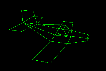

I took the time (a lot of time, but I am still confined at my ski resort) to port the software I described in the posts above to the "Ill-named SUPPER" FORTH (mistyping after all intented).
This is it :
The animation of the airplane will not be convincing on a BBQL. You will have to run it for instance on a Qemulator at full speed. To do so :
EXEC SuperFORTH ; its BLK1 is normally automaticaly loaded as a boot file, so first replace your BLK1 by mine (in the ZIP), because it will redimension Full Screen and include the FPmaths.fth package that is needed for graphics.
Then you may LOAD_FILE MDV2_PERSPECTIVE_FTH (MDV2 is just an example, adapt to your devices - my BLK1 may need to be adapted too).
Anyway when SupperForth is running, typing AROUND AIRPLANE will show an airplane turning around the Z axis, but you may change the rotation axis in real time with the 4 arrow keys : UP means Z, LEFT means X, RIGHT means Y and DOWN means reverse rotation. The SPACE bar stops the animation.
In the next posts, as time permits I will explain the details and why I dislike SupperForth (the dark side of...).

Hi All,
In the zipped code for 3D animations with SuperFORTH, attached to the post above, the words ported from the ComputerOne FORTH are in the middle between two comment lines
In front of that, I had to code some words missing in SuperFORTH and after that, I had to rewrite the animation part because it could not be done in the way of ComputerOne FORTH (and most other FORTHs that I know and have used).
1/ Three useful words to begin with :
Integer arithmetic with 16bits has a severe issue with multiply and divive operations : when you multiply two 16bits numbers you may need 32 bits to hold the result, and conversively, you may want to divide a 32bits number by a 16bits number to get a result with enough precision range.
For this, you need M* ( n1,n2 --- d ) and M/ ( d1,n2 --- n ) or M/MOD ( d1, n2 --- q,r ) operating with signed 16bits "n" and 32bits "d" integers. SuperFORTH knows only UM* and UM/MOD operating on "unsigned" numbers !!! So, to be used for my ComputerOne port of 3D animations, I had to add first the two words M* and M/. I added also a MSQRT word, computing the square root of a 32bits number into 16 bits.
2/ 3D animation control "à la mode" of SuperFORTH.
In all the other FORTH that I know and used there is a word called ?TERMINAL or KEY?, which when called will put a flag on the stack depending of "did you hit the keyboard or not". So the sequence :
will get the ASCII code of the key you pressed or zero inside a infinite REPEAT loop, letting the program to change in real time its behaviour or exit.
I used this in my other implementations of 3D animations to change the rotation, around X or Y or Z, slow it down or accelerate it and change the point of view to nearer or farther. But in SuperFORTH, this is not possible. So I had to find how to do someting similar otherwise :
In SuperFORTH you have a word KEYROW that calls the KEYROW routine of QDOS/SuperBasic : when called, with a number of row of the QL keyboard, it answers 0 or a key code depending of the key pressed.
Calling it with row 1, you can get a code for the four arrows, the escape, the enter keys and the space bar (but no other keys).
The other difference is that with ?TERMINAL you get a TRUE flag even if you released the hit key before (inside the loop) ?TERMINAL was called, whereas with KEYROW, the key must remain pressed up to when KEYROW is called ; but if inside a very fast BEGIN . . . REPEAT loop you hold the key pressed too long, you may get more than one answers on the stack. So I had to code it this way :
and before, have defined two words DREAM and WAKE-UP :
on exit of WAKE-UP the key code gotten by DREAM is used by ANIMATION to change the rotation and if as long as no space bar press the sequence DREAM WAKE-UP is repeated.
The four arrow keys are thus active for changing the rotation :
LEFT ARROW : start rotate around X
RIGTH ARROW : start rotate around Y
UP ARROW : start rotate around Z
DOWN ARROW : reverse rotation
and the space bar exits !
