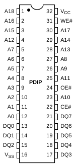

I was hoping to use either eeprom AM29F010 (128K, 8x16K sectors) or AM29F040(512K, 8x64K sectors). The latter seems still available. Cannot tell how fast these chips are compared to QL ROM.
I believe that the code can be executed from EEPROM, rather than copied to RAM, after it is linked into the system during boot.

tcat
Posts: 633
Re: QL Add-on ROM
Post by tcat »
Thanks for all the input, digesting (1 of 100% complete).
I am also thinking of `venturing' something simple of my own, me capable of.
Looking back at `Simple RAM' these are GAL equations, I pulled together with the help in the forum here.
GAL16V8
Glue logic for 512x8 SRAM
Sinclair QL RAM Expansion
(c)2014 Sinclair QL forum
# control bits set by assembler
# SYN = 1
# AC0 = 1
# AC1(n) = 1,1,1,1,1,1,1,1
#1   2    3      4      5    6      7     8   9   10
 1   NC   A19    A18    NC   /DS    NC    NC  NC  GND
 0   NC   /RAMCE VALID  NC   /DTACK DSMCL NC  NC  VCC
#11  12   13     14     15   16     17    18  19  20
  # input 1 is wired to VCC
  # input 0 is wired to GND
  # NC - signal not connected
  # / - signal active on low level
  # / NOT, + OR, * AND operators
  # enables SRAM on VALID memory range and data strobe DS
  VALID = A19 * /A18 + /A19 * A18
  RAMCE = VALID * DS
  # start of our cycle DSMCL goes high, else tristate high impedance
  IF( VALID )
  DSMCL = 1
  # end of our cycle DTACK goes high, else tristate high impedance
  IF( VALID * DS )
  DTACK = 1
# END
Now this decoding is for expansion RAM, and I wish to add some logic for expansion ROM, so the same GAL controls both RAM and EEPROM. The address could be either $E0000 or $C0000.
EEPROM 29F040 8x64K
EEPROM 29F040 8x64K
I need help around these lines above.
Tomas
Posts: 1582
Re: QL Add-on ROM
to decode for C0000 address - this is A19 High and A18 High
if you want to get E0000, then you also need to include A17 (high will select E0000 if A19 and A18 are also high)
e.g. VALID_ROM = A19 * A18
or
VALID_ROM = A19 * A18 * A17
then have a CS signal
ROM_CE = VALID_ROM * DS
That's for eprom or flash - if you wanted to use RAM and make it look like a ROM - you would need battery backup and some method of conrtolling Write access to the chip - you would also probably want to include R/W signal for selecting the chip.
