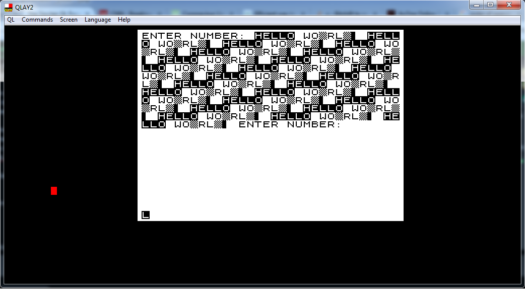

Here is the latest version. I fixed the screen so it looks more like a ZX81. Before I conform the BASIC I think I'll implement the AT command so I can do some old school graphics.
zx.zip
(21.54 KiB) Downloaded 166 times
Screen shot:

Thank you for the info. Yes, I'm using the Special Edition and have used traps in my terminal program so I will look into that. Is there a way I can get to the entire QL screen? If so, couldn't I just calculate where each character should be and then dump the byte sequence for the font to the screen directly? That would take care of the row/column issue. It would likely break a bunch of software like a pointer environment, me thinks.
Here is an updated version with 4 sample programs (using the ZXText2P graphics mapping to ASCII). I got rid of more redundant/inefficient code in the character printing functions but I only gained a little under 2% so nothing ground breaking. I improved the screen by adding a border so when the background is white it'll show better. Also moved it and resized the window to give optimal output for a JSU/F2 rom (my setup is JSU and I'd like it to work in TV mode though I can run it in monitor mode as well). The one difference is I don't show row 23 which seems to be a wasted row (buffer between output and command line) for plain BASIC programs. Not sure if machine code could access it but I just don't have the space for it if I want to keep it fully visible under JSU/F2 and the simulator won't support machine code (since it's not an emulator).
zx.zip
(22.15 KiB) Downloaded 181 times
It doesn't fully support all the ZX81 BASIC yet but does add a "QUIT" command so you can leave the simulator and CTRL-C stops a program execution. Next I'll focus on fine tuning BASIC to more match the ZX81 BASIC. Presently it allows for more SuperBASIC things which I may get rid of (if it remains it won't interfere with running ZX81 BASIC code but it might be nice to have a one-to-one mapping). I'll also add the "EDIT" feature and will start adding error codes instead of printing out error messages. I may eventually add a side menu with configuration options: maybe allow users to specify different colors for groups of characters like inverse character set, graphics set and inverse graphics set -- sort of a cheap way to add color to ZX81 games -- and if I can't easily solve the speed issue maybe add a less-compatibility mode that will use the built-in QL character set and intersperse it with ZX81 graphics (all to be determined).
